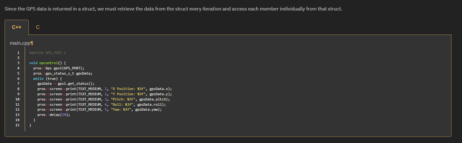

In addition, basically I am trying to print the x and y position of the bot using the GPS sensor. But the problem is when I print the x position it always gives me the same number. Also, I think this code doesn’t work because I am not using the right command or I am using the command incorrectly. In addition, if this is completely wrong what command would I use to get the x-position of the robot? In addition, I am trying to get the same number you get when you look on the brain screen, where the brain tells you its x, y, and heading direction.
Also, I would like to thank you for all the work you did to help me make this and thank you for all the help you given me. Including the time and effort you put into it.
This is the relevant section of the documentation.
You’re doing good with status = gps.get_status() (although I think you should move the line pros::c::gps_status_s_t status; to be outside the while loop). From here, to access the data just use status.x and status.y.
So all other code aside,
pros::screen::print(TEXT_MEDIUM, 1, "X Position: %3f", status.x);
pros::screen::print(TEXT_MEDIUM, 2, "Y Position: %3f", status.y);
would do what you want, I believe.
