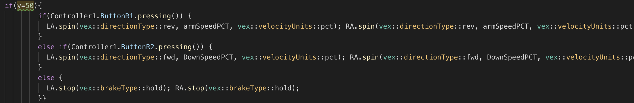

Here are the speeds for the arm
16%20PM
This makes it so that when button x is pressed and y=50 it activates that part of the code

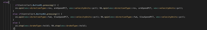

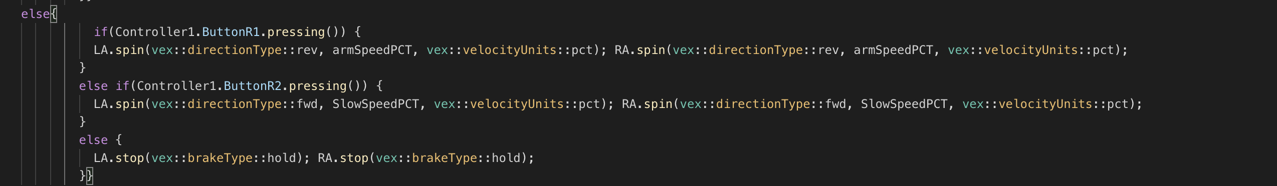

05%20PM
This is what happens then button x is not pressed and y does not equal 50

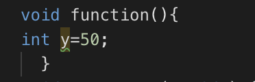

Heres the whole shabang if anyone wants to take a look and test it for themselves.
OurCode.zip (12.0 KB)
Well, it won’t work for the reasons I explained a couple of posts up, y is a local variable to the function “function” (which is a bad choice of name for obvious reasons). The green squiggle under the y is a warning, it’s probably telling you that you have variable that’s never used.
It’s never used IF button x is never pressed, so I’m not entirely convinced it won’t work. My guess is that normally y won’t equal anything, so it will activate the else. But when button x is pressed and y=50 it will switch to the other code and be a bit faster.
you have a global as well.
int y;
but function has a local variable as well, this would work (remove the variable type and assign to the global)
void function(){
     y=50;
Im not sure what you mean by removing the variable type and assigning to global
