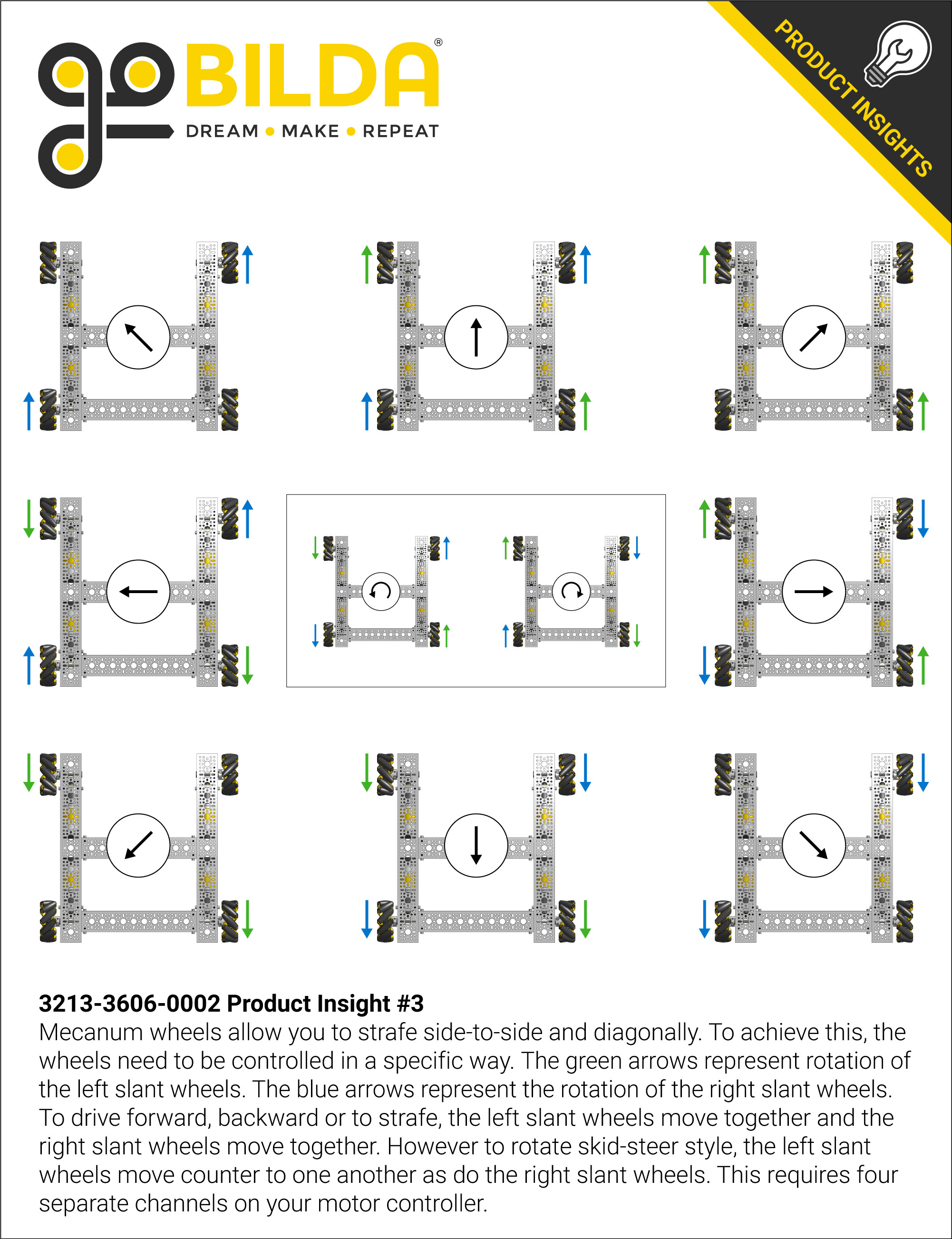

I am trying to use the diagonal part of the axis for the strides for my robot and don’t know how to program it that way 5dc33aa1b061e
Essentially, you have to use pythagoras to find out the distance (just do sqrt(abs(axis3)^2+abs(axis4)^2))
