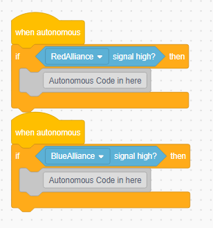

Hi, our team is trying to use jumper clips to tell our code which alliance we are on so we can have our color roller fully autonomous. The issue is, I only have access to Vexcode V5 blocks, and every other post I have found has explained how to code them in V5 text. Does anyone know how to code them in blocks that would be willing to give me some advice? Thank you!
They should be able to be programmed as bumper switches or digital inputs.

I think if you do this it would work:
The code
