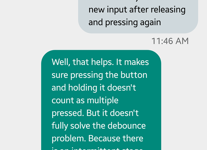

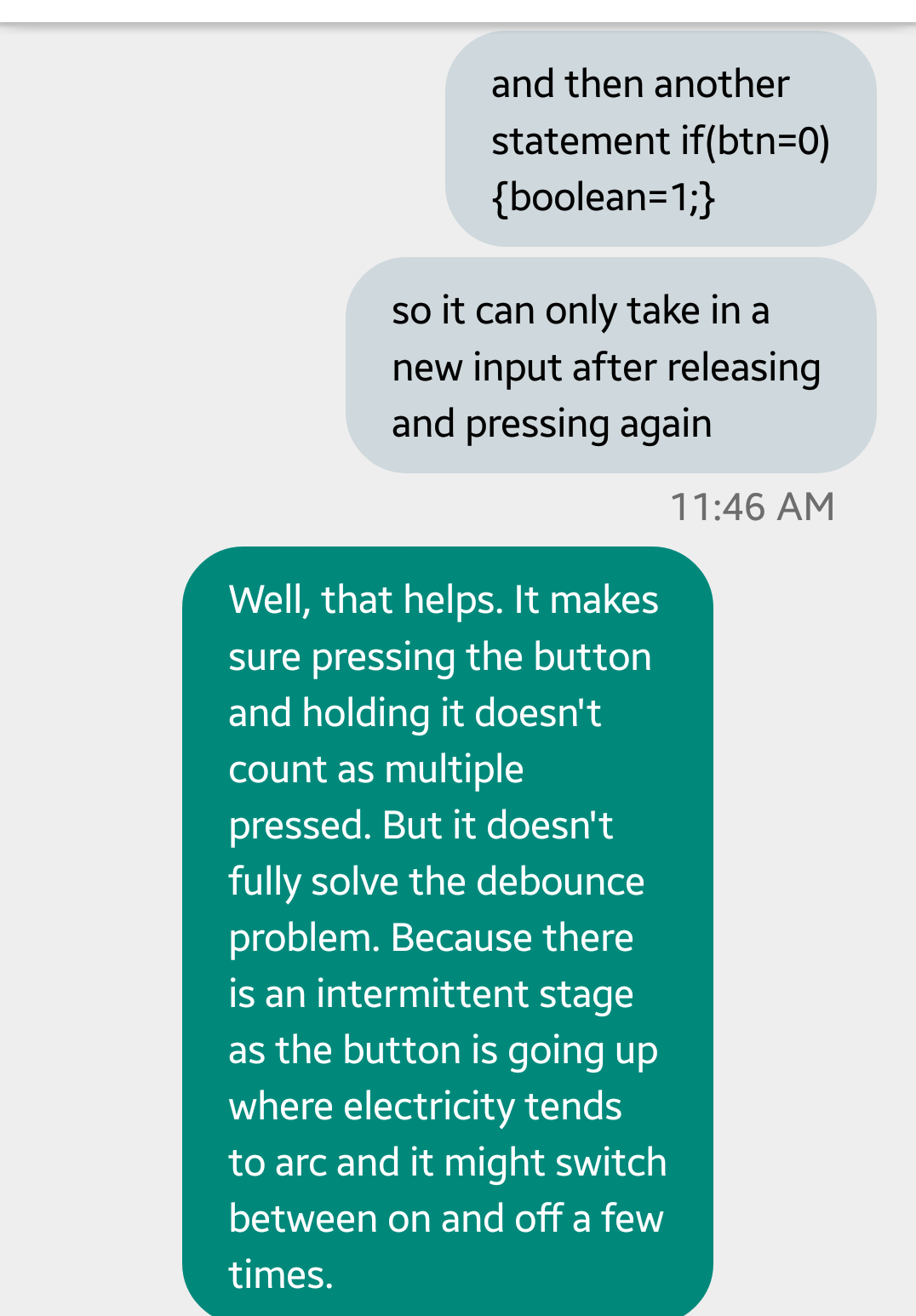

So uh, is bouncing an issue in vex?
There have been instances when limit switches have been used and mechanical stops as a backup where the coding could result in undesired outcomes. It’s more of a coding issue than a driver issue. Code what your drivers want. teach your drivers well.
We have done this many times last year and this year. I don’t know if RobotC does debouncing before populating the SensorValue array, but we have never had trouble where additional debounce code is needed.
I don’t remember whether robotC debounces or not, but it probably does. (@jpearman is your definitive source on this, though many other people will also know the answer.) Nevertheless, this is an issue of button-press dwell time. That is, the time it takes to get through a loop is a lot less than the time it takes a human to press and release a button.
Correct, we use a last state check, and haven’t had issues with bouncing on the signal.
