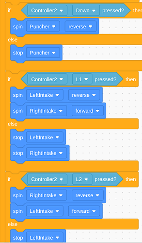

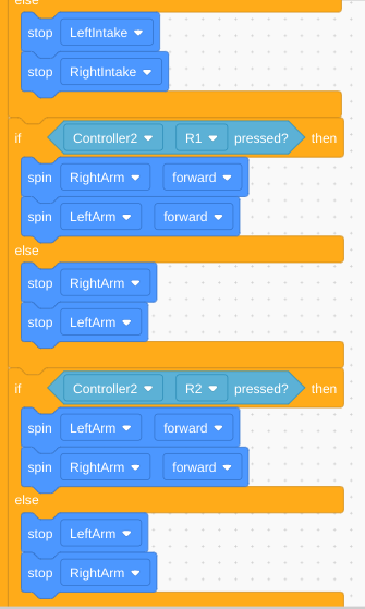

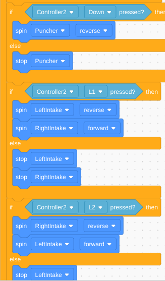

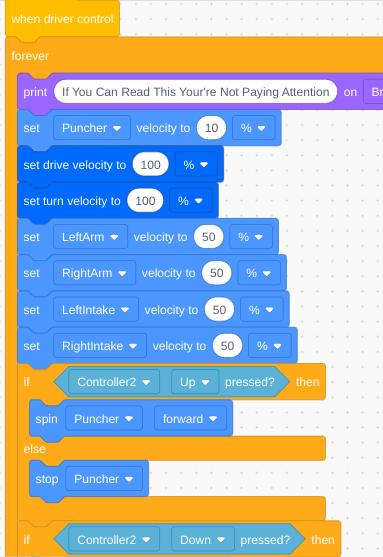

I have a competition in 1 week and my school somehow blocked the text and I have no more time to wait. How can I code a 2 motor driver control code? Thanks

I’m no programmer but at a glance it looks like your motors are running all the time. Your ‘set velocity to <#> %’ blocks are in the forever loop, so they’re start running as soon as the program starts, which doesn’t seem to be what you’d want. Instead, move those blocks into the ‘if then’ blocks, that way the motors only spin when a certain button on the controller is pressed. But all that aside, with the else blocks and stopping motors it seems to be good.

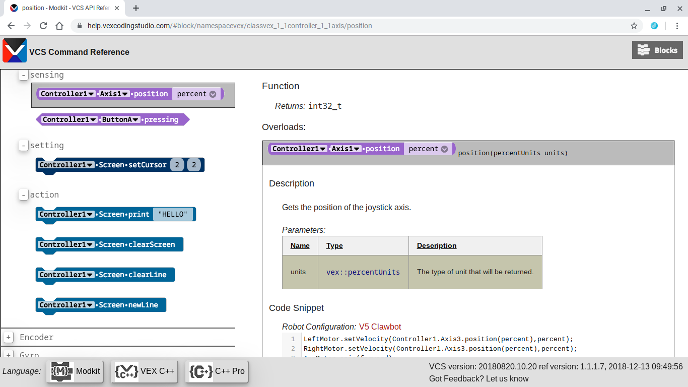

No, ignore what I just said about your motors running all the time (finally found the modkit API). However, if your issue is trying to program a two motor drive, in modkit you can have the motors running at the speed of your analog sticks settings so that’s a pretty bread and jam way of getting it to work. I’ll try and attach a picture in a sec if i can do this right

I can’t do this right, but if it helps this should be the block you are looking for to use the analog sticks on the joystick to control your drive motors:
For a tank drive, set the left drive motor to the value of the left analog stick, and the right drive motor to the right analog stick. Can’t get any more basic than that.
