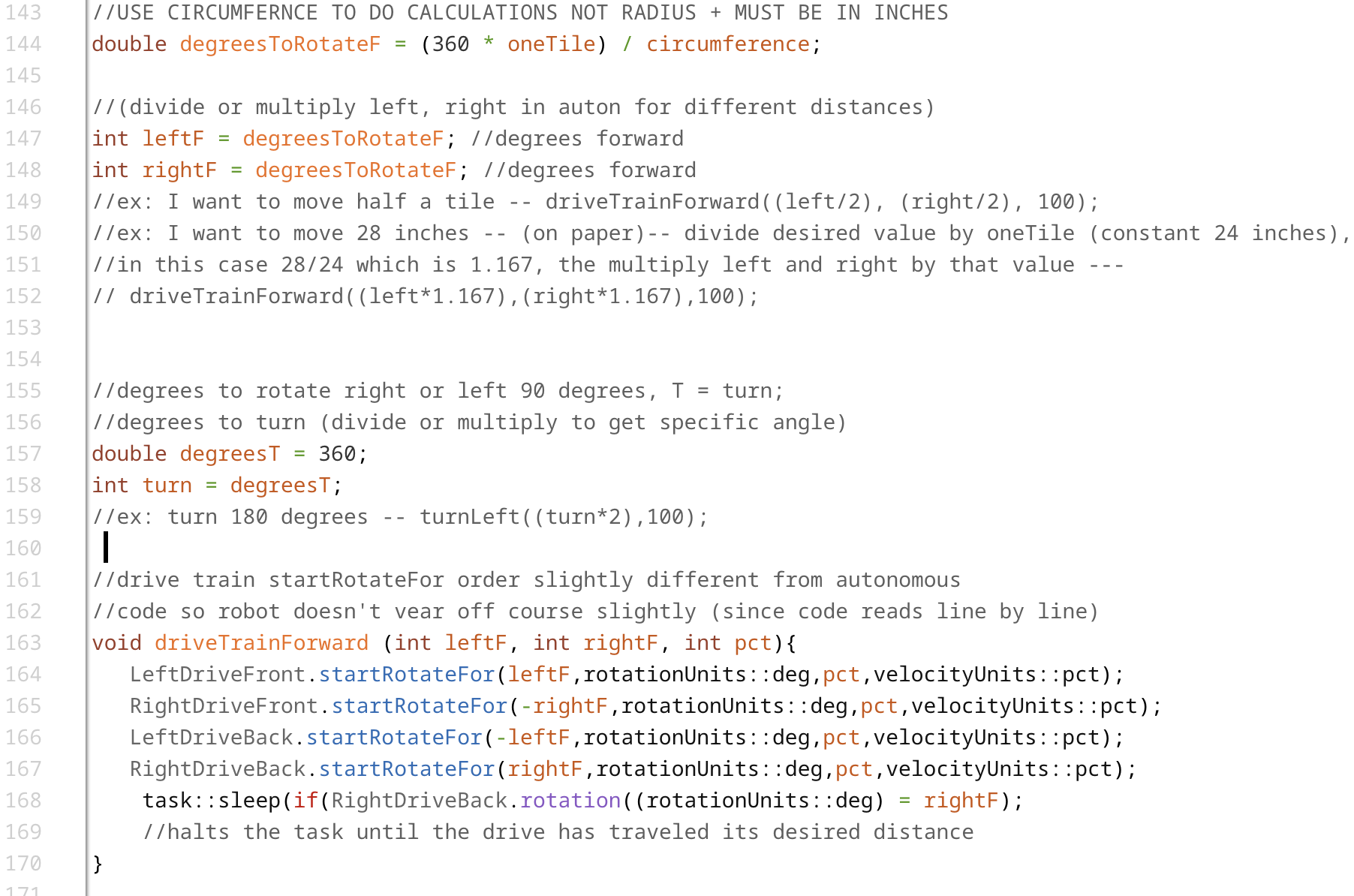

The problem is that I need 4 motors to synchronize and stop at the same time. I use non-blocking code for this but I this is gonna be variable since it’s for autonomous and I coded it in one of the methods I made. I’ll post an example of what I’m trying to do. In the driveTrainForward, I want the task to sleep for the amount of time it takes for a motor to spin to the target position I have coded but it should be able to change because when I call the method the target position changes to what I have set. So instead once the motor spins to the desired location which changes depending on the distance I want it to go, the task will sleep for that exact time and maybe a 20 millisecond added delay. I don’t know if that made sense. I also used an “if” statement for the sleep command which won’t work but it’s easier to understand what I’m trying to accomplish.

As far as I can tell from your code you can just change the startRotateTo to rotateFor and just stop the motors after that. That way it will rotate the correct distance and you don’t need a wait time.

The basic idea is that you have a variable that you can lock so that only one task/thread can change it at a time. So in your drive thread you lock it. When you reach your target, you put in a small delay and then unlock it. The other thread isn’t really idle, it just keeps waiting until the variable becomes unlocked. Only once that variable becomes unlocked does it do anything. But it seems like you’re really overcomplicating things. Why not just use a function that calls the function to move as a regular function and then follows it with the next function?
Well, for starters, you have far more “(” than “).” Also, what are you trying to return from the if statement? It looks like you’re setting a value to rightF, but never really comparing anything; note the difference between “=” and “==” in that line. And then you’re not doing anything with the “if.” Finally, it seems like you want “while,” not “if.” Something maybe more like this:
while (rightDriveBack.rotation(rotationUnits::deg) < rightF){
   task.sleep(10);
If you do want to use in-line if statements, try looking up ternary operators in C++.

rotateFor is blocking unless you include “false” at the end of it, in which case it’s the same thing as startRotateFor. So just change the very last one to rotateFor. Yup. This is why I’m curious about what is really being done. Why make it so complex when it’s not doing anything. I would just run a function this way and then do whatever is next without any task/thread for this.

I wrote this out when I had the robot in front of me and through some trial and error I came up with that, there is likely an easier way to code it but it works and I understand it. I would consider redoing it in a simpler way but keep in mind I’ve taught myself everything on there. Basically the method takes the length of a tile and converts it into rotations that the motor can turn to, then those rotations are set = to left and right and you would simply multiply it by a factor which would be found through some basic algebra to the find what you would need to multiply the rotations by to get the motors to spin to the desired distance. I don’t know if that made much sense but I fully get it in my head. What would you propose I do to simplify this in a step by step sort of process as I have just explained.
#15
you cannot pass an expression like “leftF*constant” as a parameter (meaning leftF multiplied by constant)
I’m not sure why you think you need to check for the motor traveling the requested distance, that’s what rotateTo does. There is also an “isSpinning” method you could use if you wanted to do it yourself. If you are worried that the motor will not achieve the requested distance and want to bail after a certain time, rotateTo can also do that for you, set the timeout period using the “setTimeout” method (remember to change it back if you made it something small)

How about this?
void driveTrainForward (int numTiles, int pctSpeed) {
   int degreesToRotate = (360 * oneTile) / circumference * numTiles;
   LeftDriveFront.startRotateFor(degreesToRotate, rotationUnits::deg, pctSpeed, velocityUnits::pct);
   RightDriveFront.startRotateFor(-degreesToRotate, rotationUnits::deg, pctSpeed, velocityUnits::pct);
   LeftDriveBack.startRotateFor(-degreesToRotate, rotationUnits::deg, pctSpeed, velocityUnits::pct);
   RighDriveBack.RotateFor(degreesToRotate, rotationUnits::deg, pctSpeed, velocityUnits::pct);
You then call this function
driveTrainForward (how many tiles, how fast);
I think you had “constant” for the number of tiles, which I wrote as “numTiles” to be clearer. I also don’t like “pct” when there are other “pct’s” so I called it “pctSpeed.” When you call this function it will turn on all four motors, rotate them to where you want to go, and pause the code in the task that calls it until it has gotten there.
Then after calling this function you do whatever you wanted when you get there. So if you want a 20 ms delay, maybe to stop some shaking, and then something else, you would have
task.sleep(20);
something else;

You’ll want to change int numTiles to float numTiles. Or you could divide that 360 by 24 to have the conversion factor be for inches, and then use float numInches and directly put in the number of inches instead of figuring out the fraction of 24 inches yourself.
