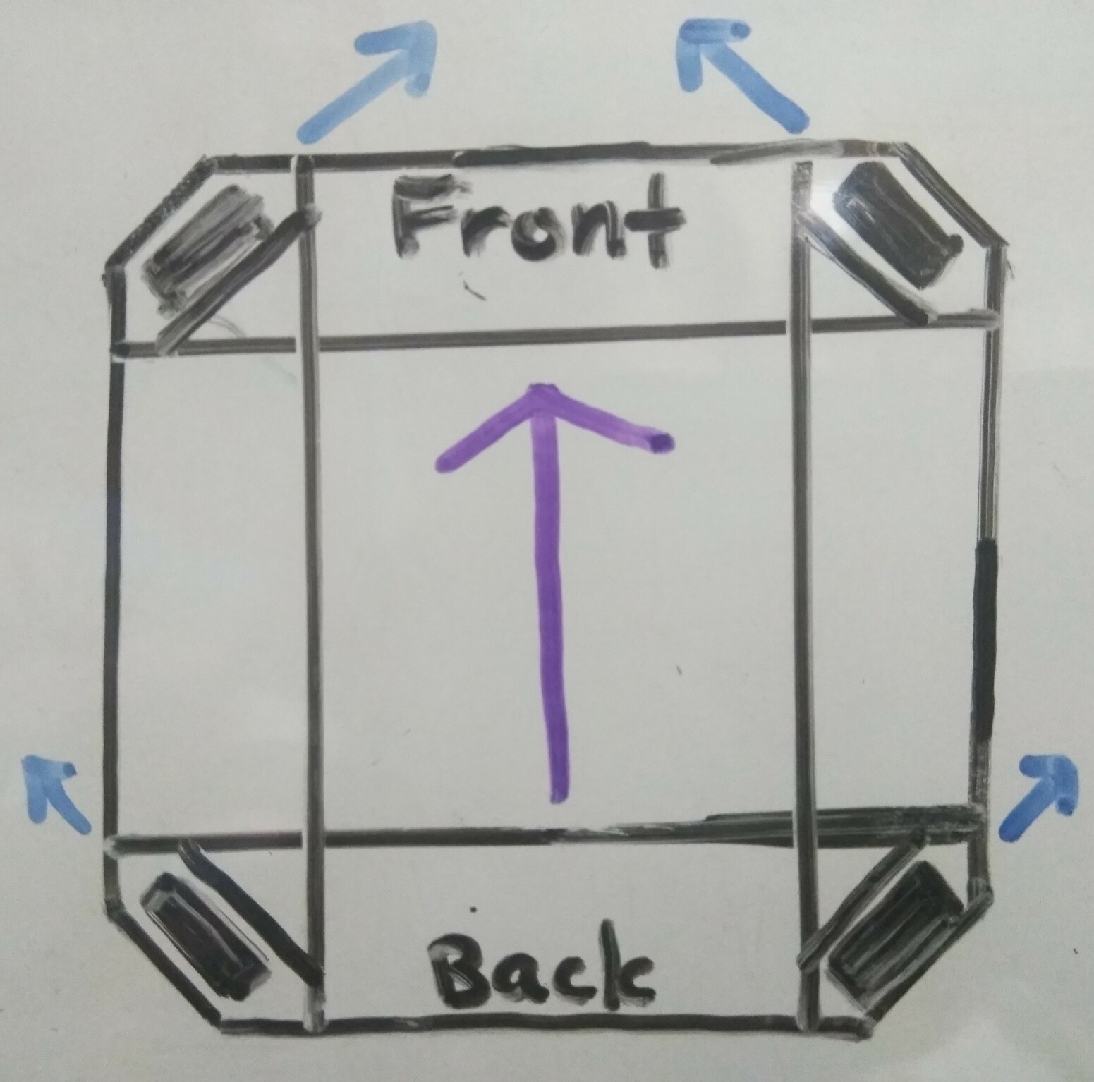

Please post your code. Chances are you didn’t do it. Also make sure you know which wheel is in which port.
If you spun wheel FR (front right) “forward” (which we define as this direction, in light blue), the robot would go more or less this way (in purple):
And if you spun wheel FL forward, it would go this direction:
So if you spun them both forward at the same time, the arrows would “merge” and the robot would go forward:
But of course, the same thing works on the back; the right-forward arrow from the BR wheel merges with the left-forward arrow from the BL wheel and the left-forward arrow from the FR wheel and the right-forward arrow from the FL wheel. All four of these arrows are going forward, and the two going left (FR, BL) are counteracted by the two going right (FL, BR):
And that’s how you go forward.

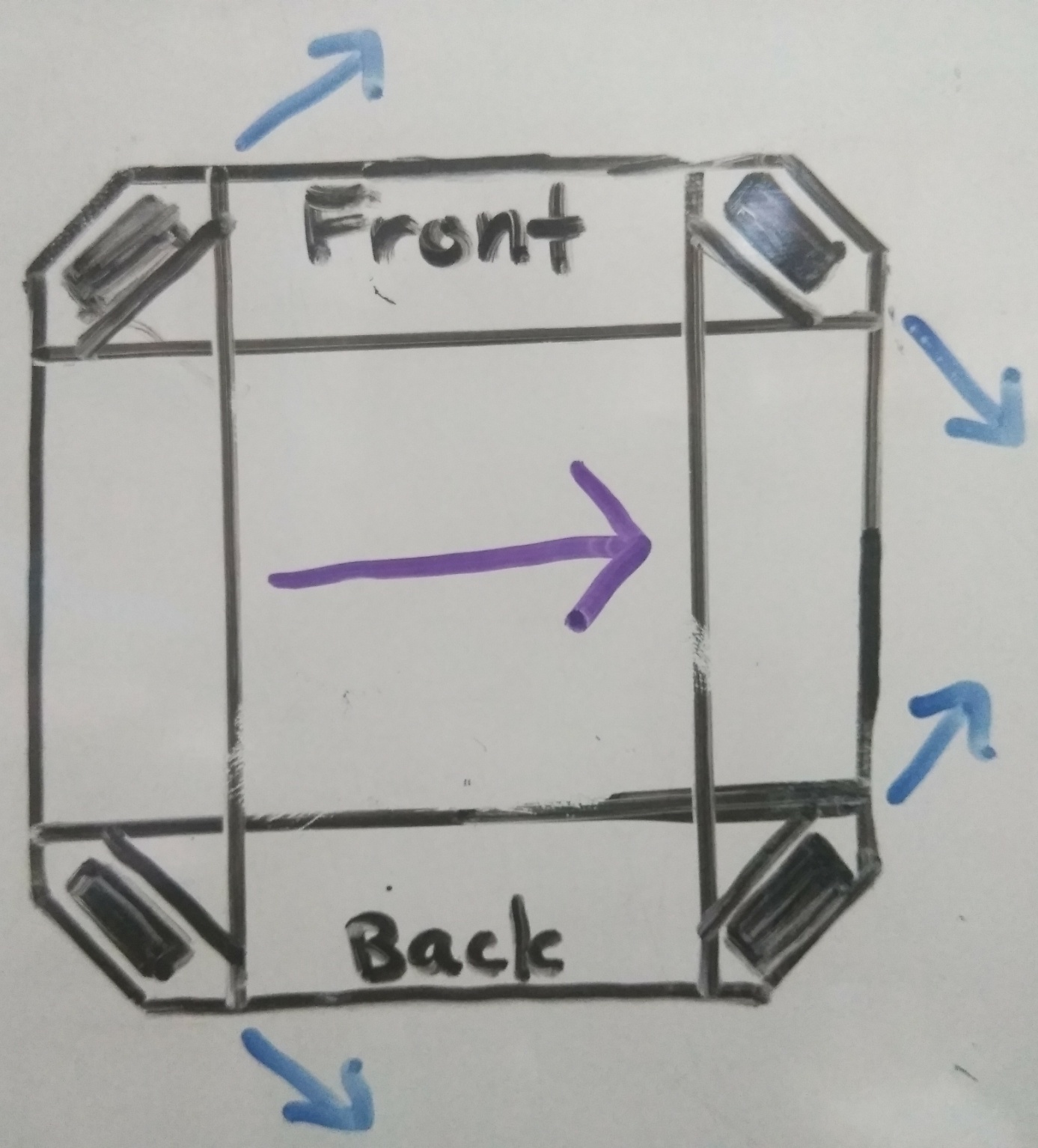

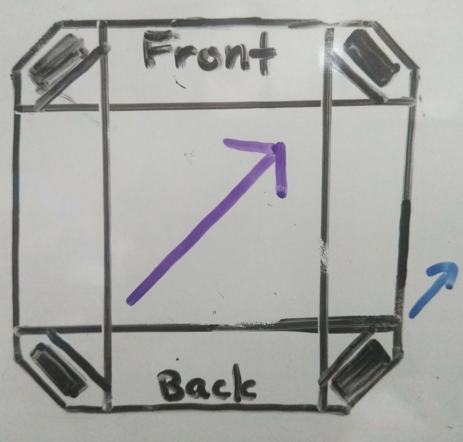

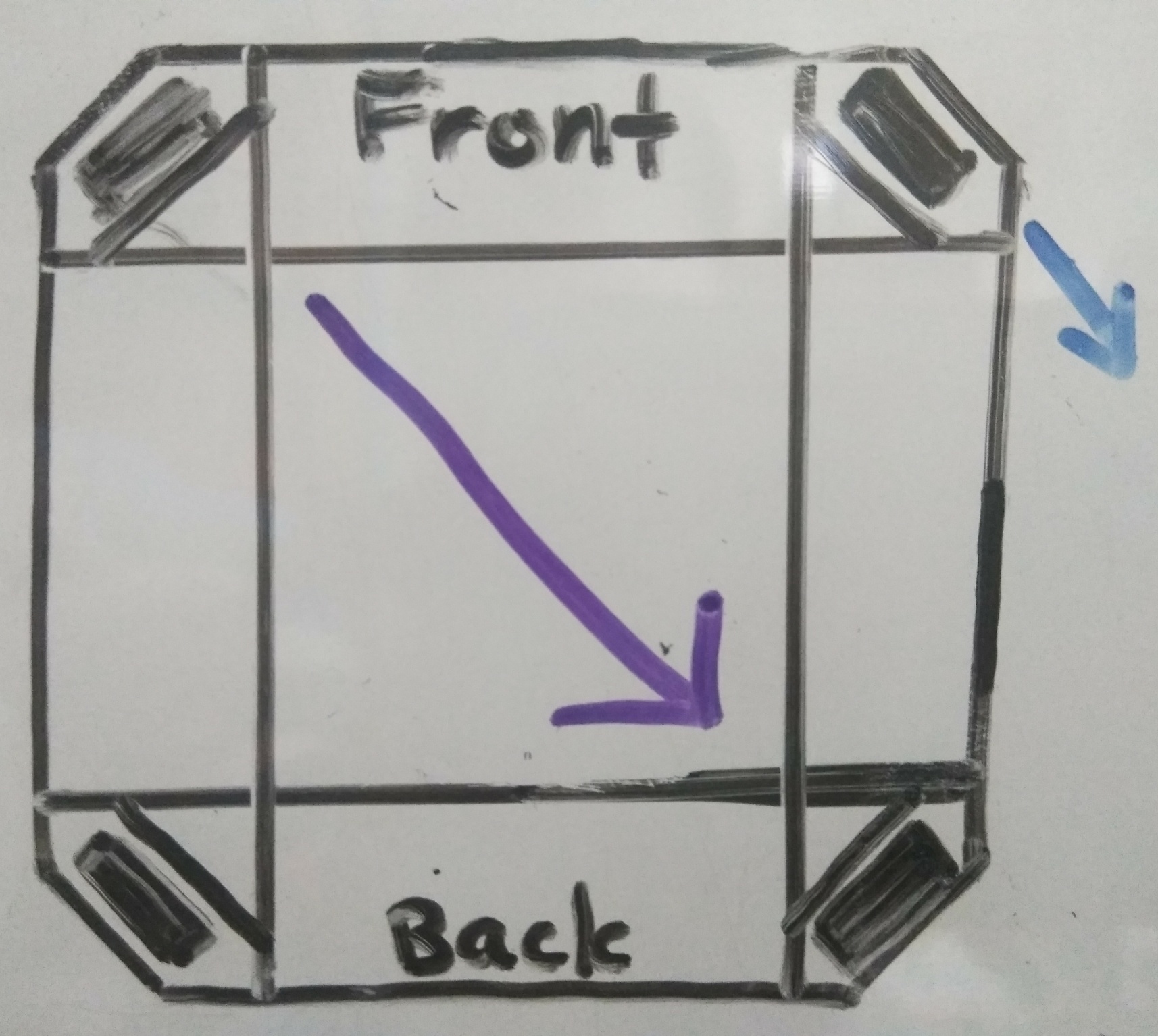

If you spin FR backward, it will pull right-backward:
If you spin BR forward, it will pull right-forward:

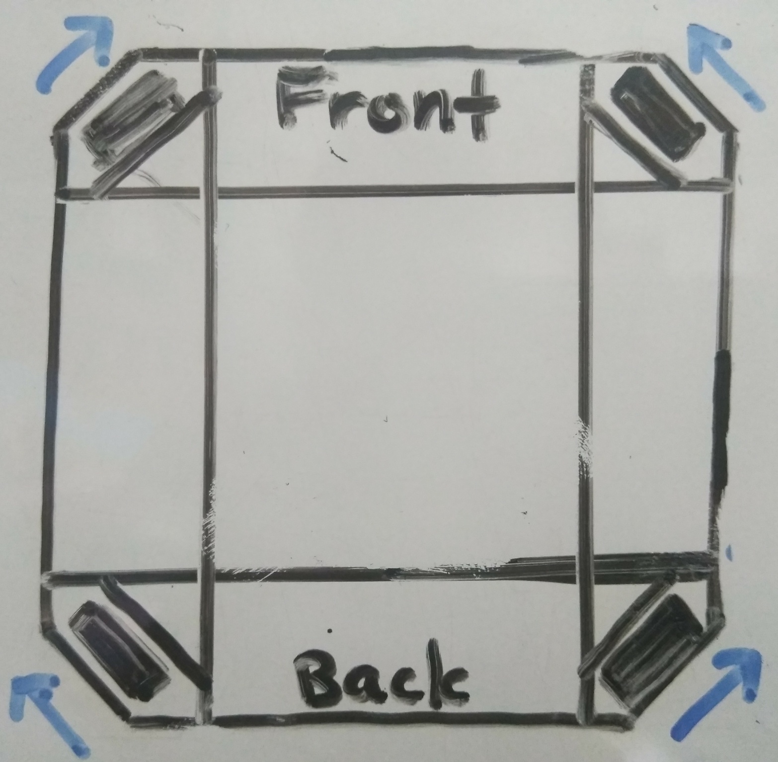

Etc. for FL and BL. If you spin them all in these directions, you get right-forward, right-backward, right-forward, and right-backward, so that the two forwards are counteracted by the two backwards but all four rights work together so that you go right:
Once you understand this, you just have to figure out how to add and subtract the various axes (plural of axis) of the controller so that you strafe and spin intuitively. You could copy the code HazeL posted, but you’ll learn more and remember it longer if you figure it out yourself. If you opt for figuring it out, I would recommend you start by making it just go forward and backward, and after that works, add strafing side to side. You’ll have something like set FL velocity to axis 1 + axis 2 etc. And after you get strafing in any direction working, you can add in spinning (which of course is important).
