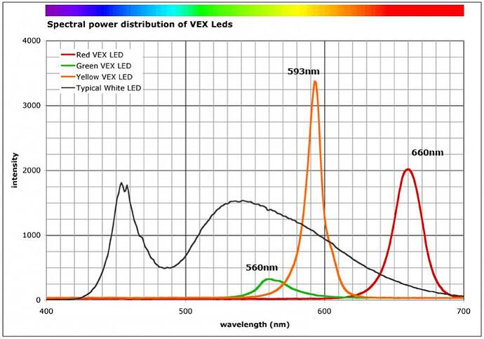

What color filter would I use for the light sensor to see the yellow middle platform and not the red or blue platform?
And what material would I use for the filter?
I suppose you could use what’s known as an optical bandpass filter. You will need to search for it by wavelength, which is usually in units of nanometers (nm). If you’re wanting to filter out all but the yellow, then you need to determine about what wavelength that particular platform yellow might be. Yellow tends to be around the vicinity of 570 nm on the spectrum. These types of filters tend to be expensive but maybe you can find something used on eBay or elsewhere. I expect you are looking at around $25 to $50-ish no matter what you do.
Or you could overlap two “cut off” filters: a “long pass” filter (which lets in the red end of the spectrum) with a short pass filter (which allows the blue end to pass) so that only the yellow gets through. Again, expect to pay, pay, pay.

A short pass filter that lets blue through should not allow any yellow through at all, or it won’t be a blue filter, a blue filter being a negative yellow filter. I think you were thinking of a green long-pass filter.
Meanwhile, be careful. Just because the platform appears reddish doesn’t mean it doesn’t reflect yellow light, too. If you restrict the incoming light to that region of yellow, the red will probably appear to be dim yellow as opposed to black. But dim should be OK since you can set a minimum brightness on the analog reading you get from the light sensor.

I suppose it depends on what sort of filters you might be talking about. Theater lights maybe? All I know is that short pass optical filters used in many science and industrial applications have a range of transmissions that can be relatively narrow or allow more than half the visible spectrum through. See, for example, this particular shortpass filter that allows 350 - 612 nm, blue up to yellow and beyond:
https://www.edmundoptics.com/p/625nm-125mm-diameter-od-4-shortpass-filter-/27767/
In that link, click on the blue tab marked “Curve”. This will show you the light transmission for this particular filter.
In the optical world, “short” simply refers to the blue side of the spectrum (shorter wavelength). “Long” refers to the red side of the spectrum (longer wavelength). But neither of those terms necessarily implies a particular color; it can include a range of colors.

The filter is a piece of gel that I got from the theater department at my high school. It’s the clear colored plastic stuff that they use to cover the white stage lights to change their color. I tested it and it works really well. I layered a piece of amber gel on top of a piece of green gel and it filters out the red and blue platforms and only sees the yellow one.
