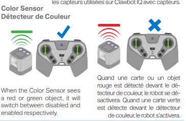

We are using the demo/sensors built in code. The students are using the remote to guide the robots to clean up a chemical spill so they need to avoid red spots I placed on the field. However, many, not all of our 36 robots are stopping on the black. I have tried updating, swapping out the color sensor, the touch LED, the brain and nothing is working.
The colour sensor has multiple modes. When sensing colour, it can’t determine between black and white, just hue values. My guess is that the black lines are returning a green hue value and triggering this part of the built in code:
You will need to write your own code in VEXcode blocks to handle avoiding the black lines on the field.
