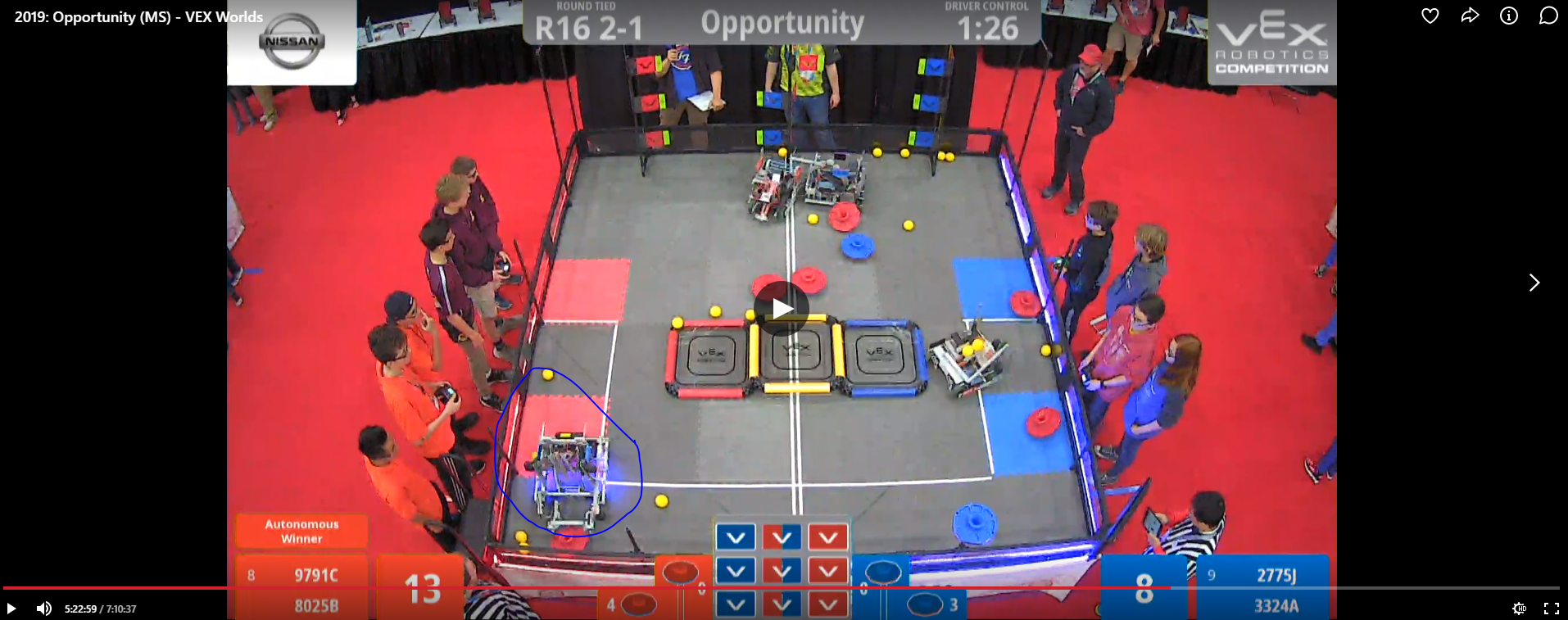

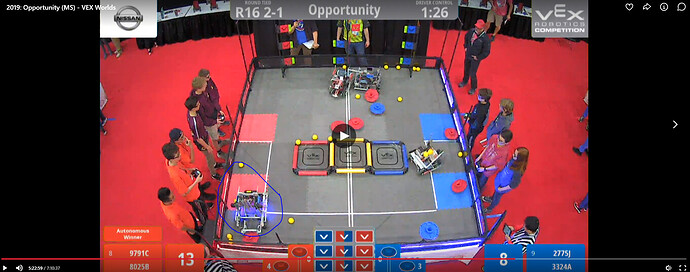

Me and my teammate (@Zenix maybe pay attention) were thinking of putting red and blue strip lights on our bot to denote alliance color. Would this be allowed, as it cannot be confused with cube color?
@2775Josh had those LED strips at Worlds 2019, and assuming that they passed inspection, it was allowed for sure in TP.
R8, pt. g in TP is identical to R12, pt. e in TT.
