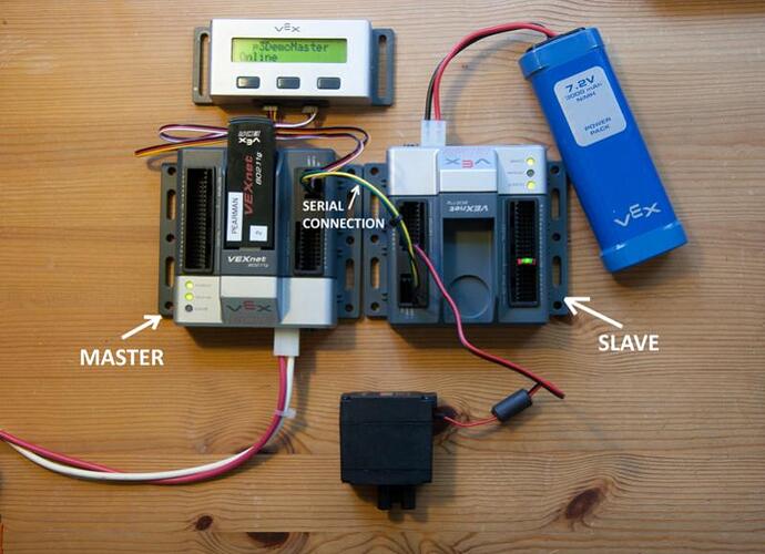

The code linked at the end of this post allows two cortex controllers to be connected using their UART ports. The master cortex (with VEXnet and joystick) controls the slave cortex (no VEXnet) using the example communications protocol.

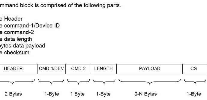

**Format of a data packet.
The protocol is not that different from others I have presented in the past. All communication is initiated by the master cortex, it sends a packet of information (several consecutive bytes) to the slave. The slave replies to the master with either an acknowledge (ACK), requested information or an indication that an error has occurred (NAK). Any baud rate can be used but for the example code I am running at 230.4K, pretty much the highest standard rate supported by ROBOTC.
For complete information on the protocol see the document here.
p3_cortex_protocol_d1.pdf

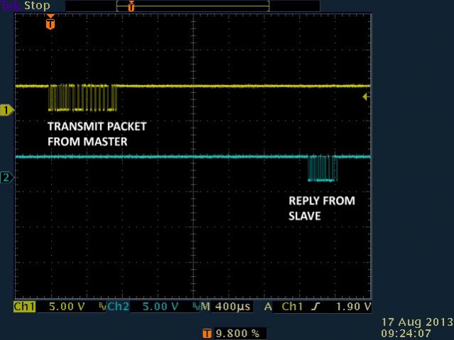

A serial transaction captured by an oscilloscope appears as follows.
Due to the nature of the ROBOTC implementation there will always be a small delay between command and reply, however, this really is not an issue and still easily allows a message to be sent every 10mS (100Hz).
**Connection between host (master) cortex and slave
