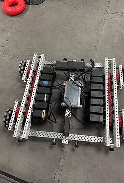

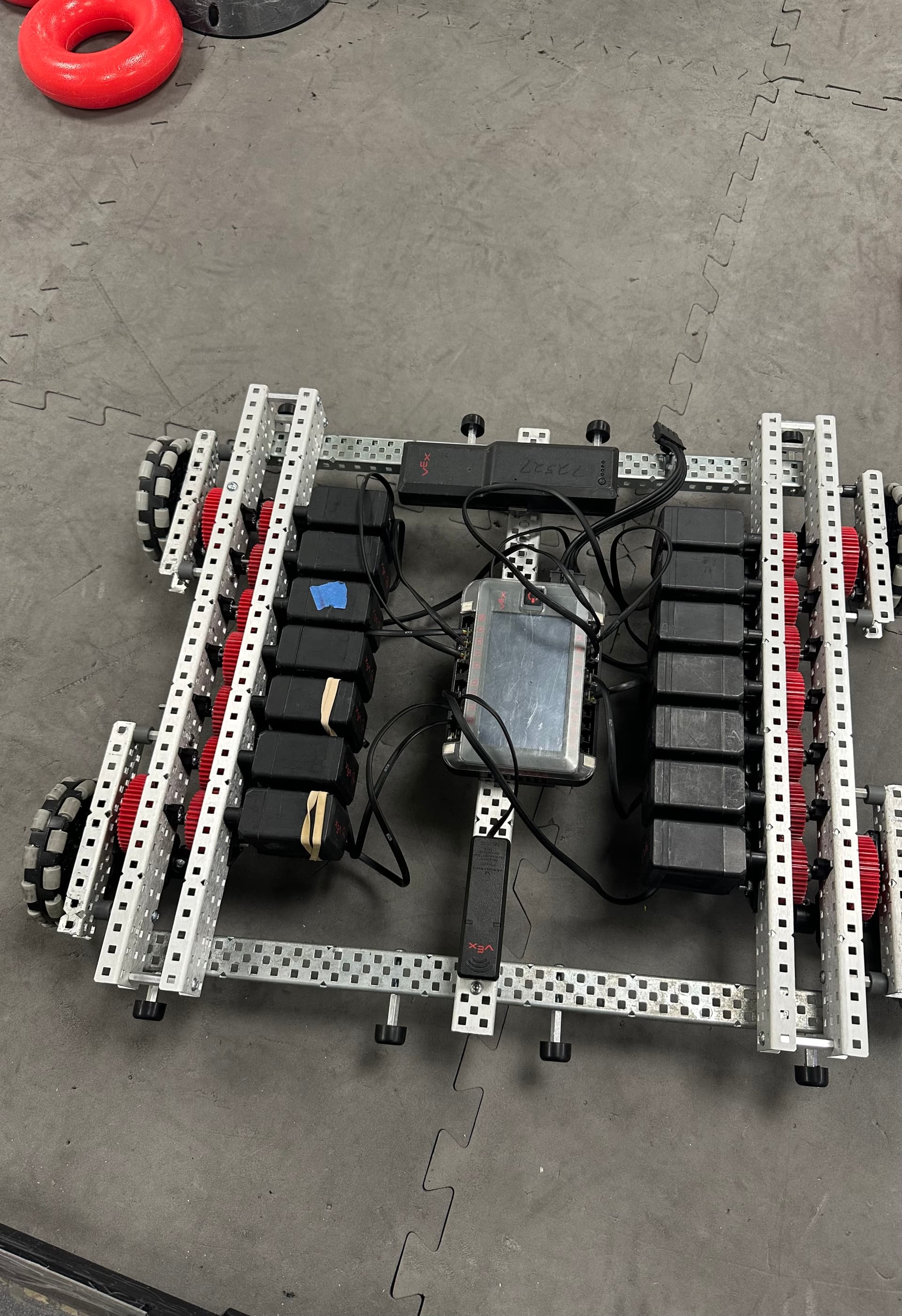

One of our teams was bored recently and made this 14 motor drivetrain
All of the motors here are high speed and geared up
After testing in the parking lot, it was clocked in at about 20 mph
I don’t know how accurate this count is though.

Do you have a video? I want to see this so badly.
