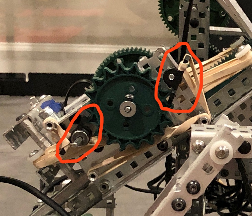

@Atomic Okay, I scrounged up This post and it has the best picture I have of it and an accompanying explanation. Here’s the picture from it for quicker reference. IMG_2698
Edit to add information:
There is an axle inside of those gussets constantly pulling down on the 6t sprocket. The way the ratchet spins, the axle holds the sprocket, and thusly the slipgear it’s mounted to, in place. Hence being effective.

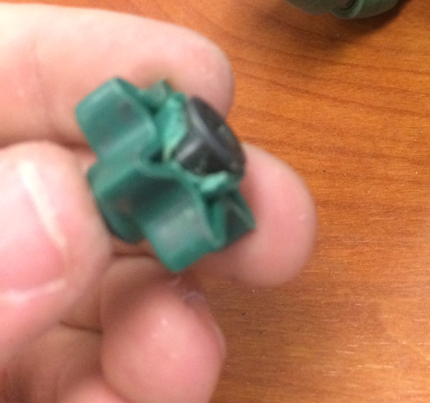

Still, please don’t use a 6 tooth sprocket. The extra space is worth it so that
https://www.vexforum.com/uploads/default/original/2X/b/ba61cc8bdda27806dd8a06230a1f80015380c3a9.jpeg
Doesn’t happen. I swapped it out once, and it was fine for the rest of the season. Just a random building flaw that can’t be seen in the picture coupled with strainious use as it shouldn’t have been used. (Use had to launch those caps, didn’t you, GASL?)

This isn’t the only way to make a custom ratchet. You could also stack together at least 2 pre-fab ratchets and pawls to achieve a higher strength.
It might also help to see the mechanism in question, as I’m still not sure I completely understand.
