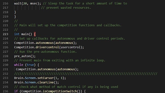

So after adjusting some code for my bot the competition function declaration is giving me a problem. I’ve coded a drive train, and an arm lift with 4 motors on the drive and 2 on the arm so far. We have a competition tomorrow so any help asap would be appreciated!

What exactly is the error that is being given? What does it say if you hover over the red highlight?

So the error given is “Function definition is not allowed here”
As for why it was changed, I don’t know. The code was from our previous year’s bot program which was coded by someone else.
I just changed it back to the original competition function and it is still giving me the error.

Huh. Interesting.
It looks like whoever programmed this before was doing some printing inside of the main function. Probably not too bad, assuming it worked.
It appears that you don’t know exactly what you are doing with this code. Maybe I’m wrong, but you don’t seem to have the best understanding of it (Granted, I don’t have the best understanding of it either, it’s not my code). It may be better for you to just start with the blank Competition Template and use that.
As for the error, you (or whoever was programming) forgot a curly braces in driver control. There was apparently nothing wrong with main, so you could switch it back to the cool feedback code if you wanted. End of Driver should look like this:

Yeah, definitely. I just copied what you put and it seemed to work, had to delete the print screen stuff though because it was all marked as errors. Where would a good place for that part of the code to go?
Inside the while(true) loop that is in main.
Ok, just did that.
Thank you so much for your help, been a real life saver.
