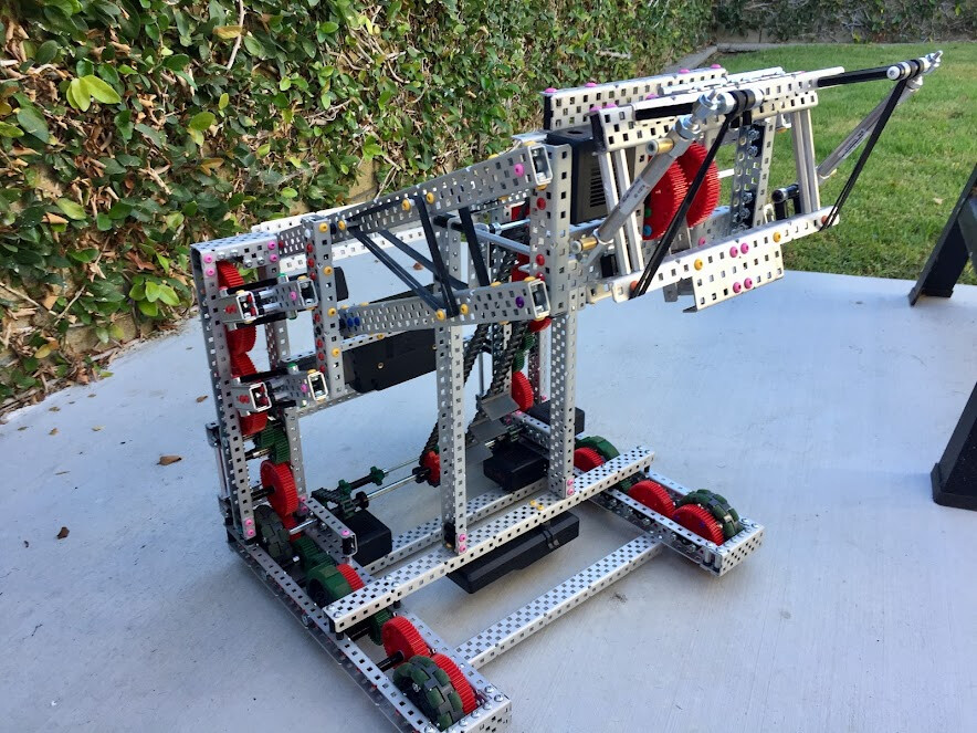

I’ve found there’s actually a lack of discussion about what people are currently doing for their robots. Specifically, pictures of their robots. Now, I understand some people don’t want to have to show what ideas they’re using. However, for someone like me who doesn’t want to use other people’s ideas, but merely see what people are using and what seems prominent, something like this sounds really helpful. If you want to show off your robot, feel free to share it here. This is just to have fun sharing pictures and maybe talk a little about what is popular or what you think will be good in the meta if you see something that strikes your attention. Here’s mine:
It’s really fun and completely takes away the use of a mobile goal by storing it inside itself. We are making it better, but it worked well for our scrimmage we had last weekend. Ignore the claw on it. It was a quick add on we put on the day before for autonomous. :sweat_smile:

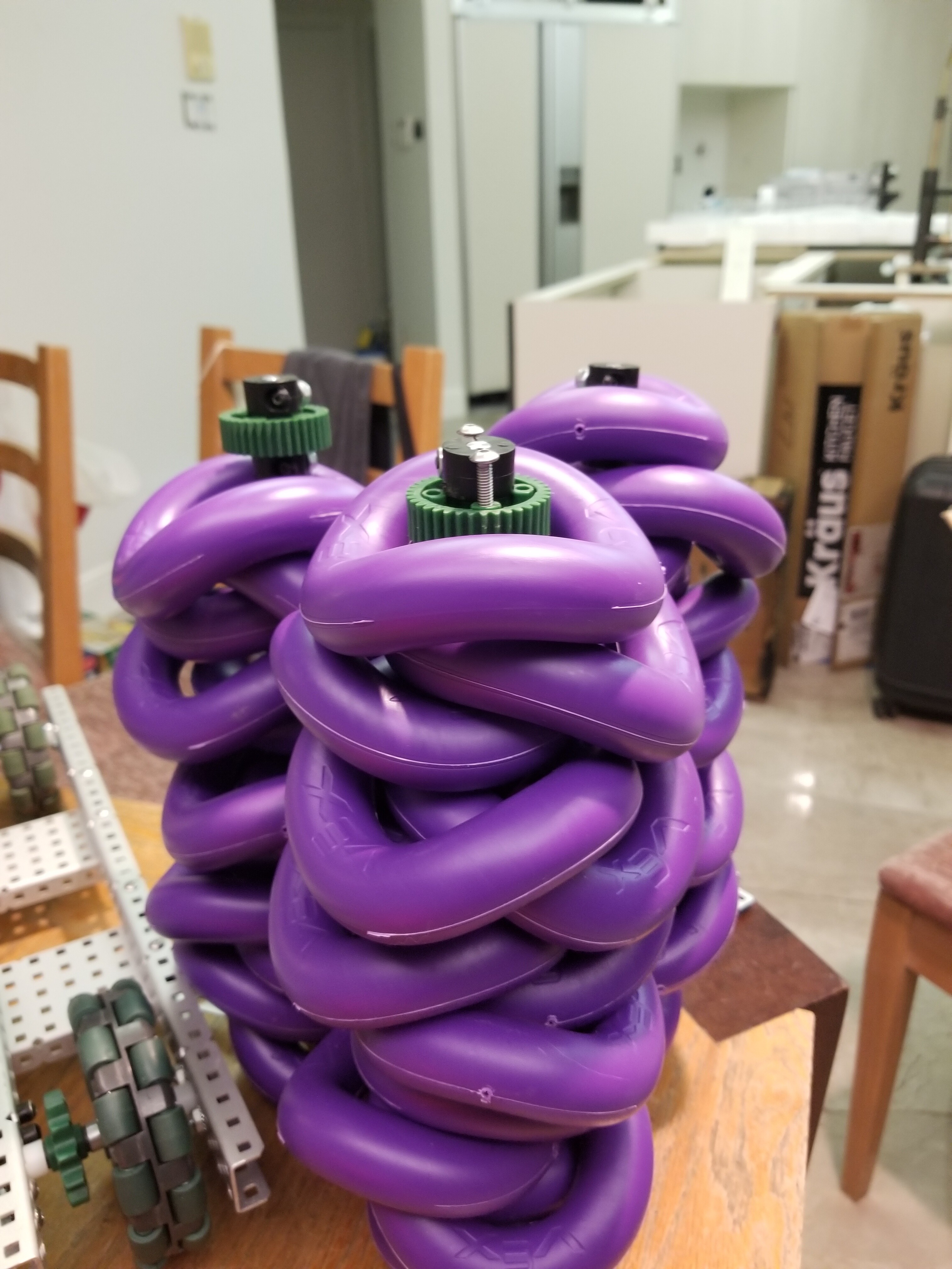

Plenty of new half•alive songs to pick from…
Leeks

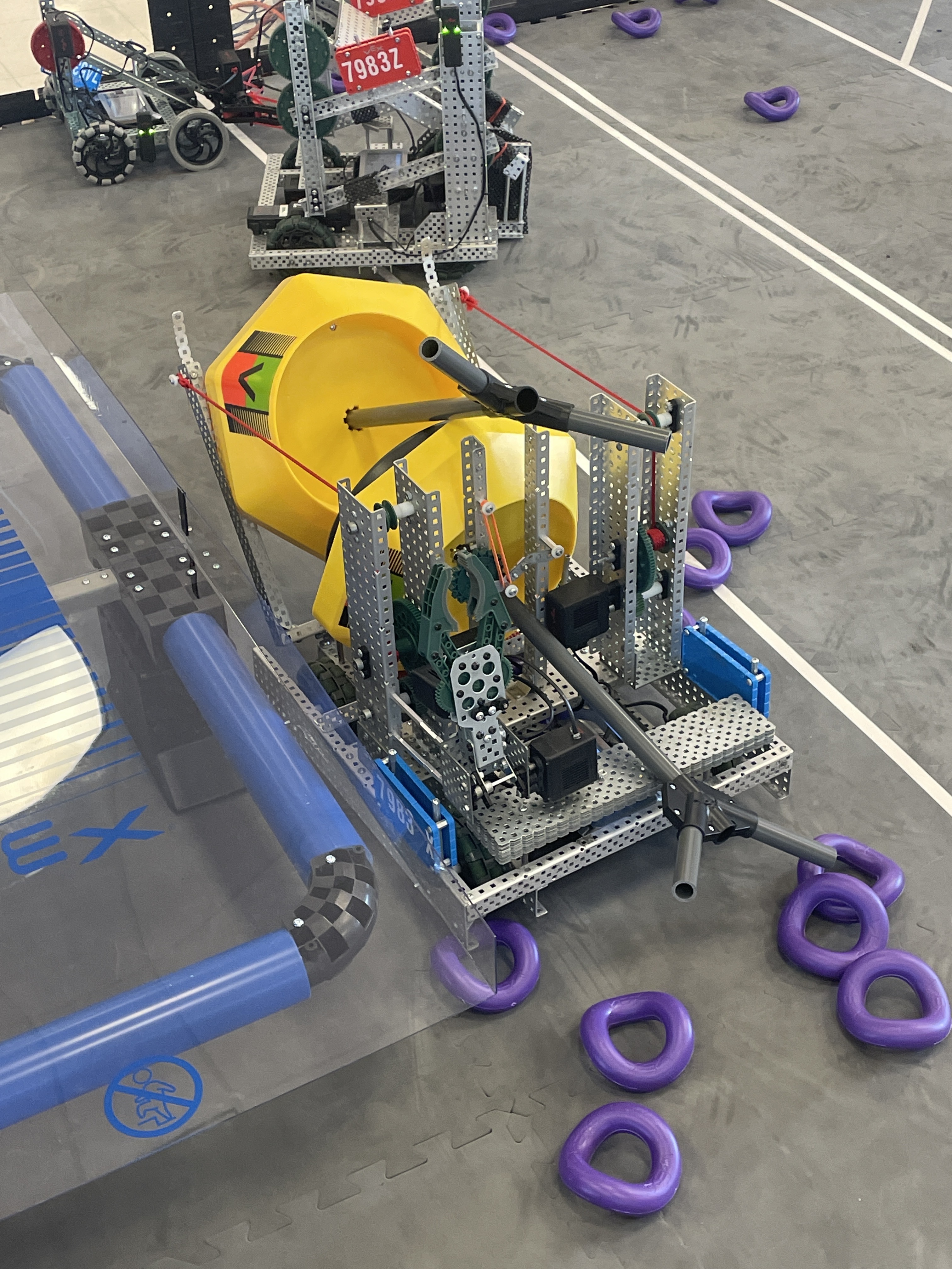

Here is a picture of our current bot, we are doing one of the styles that @Xenon27 mentioned, the double mobile goal only bot. It’s been working pretty good so far.
I second what @Xenon27 said about this years game, I hope there will still be a lot of mixed designs out there later season.

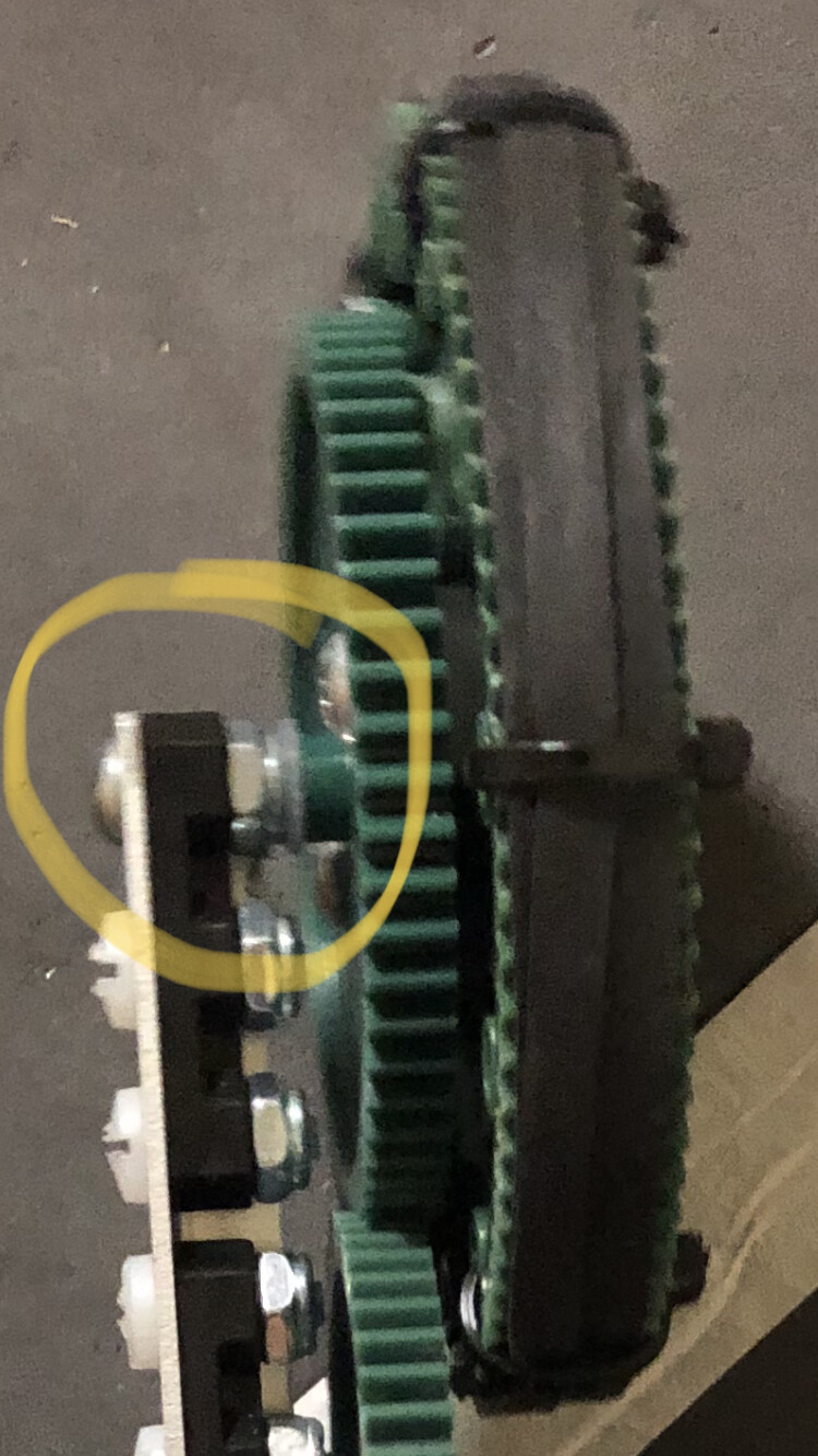

Screw Joints, if you are cantilevering it (and sometimes even if you aren’t).
Screw-metal-keps(or nylock) nut-spacers/washers-wheel-nylock.
we tried a screw joint but then we cant put a bearing on both sides of the c channel bc one side makes the bearing mount at a slight angle
You don’t need a bearing if you do it like I said
Here’s an example of a screw joint @Hao_16688C
I’ve used a thin nylock instead of a kep’s nut, that would be up to you however. Hope this helps!

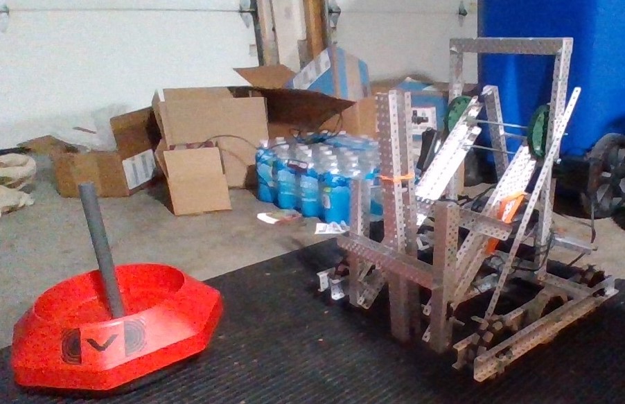

Imma leek my robot too.
(Don’t mind the stuff in the background. I do robotics in the garage.)
I’m sorry for the bad quality my computer camera is really bad

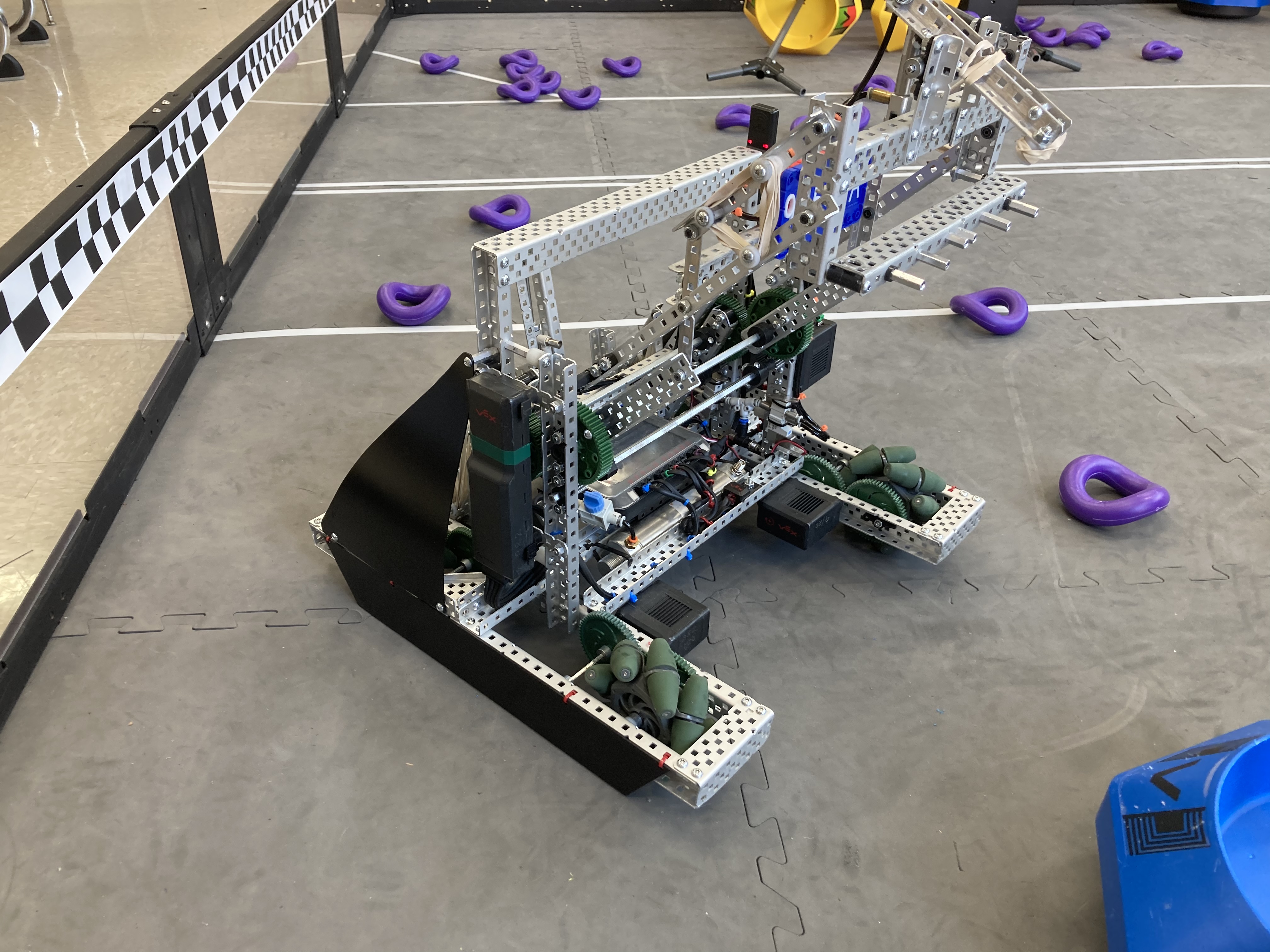

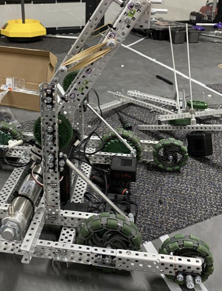

Here’s my bot. We took a different approach, but wanted to be a consistent ring scoring bot with possession capabilities. Solid in scrimmage matches, got first comp next weekend :slight_smile:
