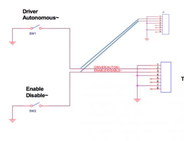

On this diagram, should I tie all the grounds together?
Yes, all the grounds must be tied together in order for it to work.

I am a student trying to create a switch to test my robot’s autonomous mode and was wondering if anyone would be willing to explain the diagram(which wires are ground, where do I attach wires to, what do the large arrows and small x’s mean) or point me towards a video on youtube explaining the process of making one of these? Thank you for any help you can provide.
Don’t take this the wrong way but, if you cannot understand the schematic, then you should probably not be let loose with a soldering iron.

I want to check if this is the correct way to hook multiple controllers to the same switch and that it won’t fry anything. The two grounds would of course also go together. Sorry about the horrible diagram modification.
Alternatively, does anyone have a wiring diagram of the switch VEX sells?
This will work.
Everything is just connected together. You may also be interested in this if you have not seen it, schematics for the field controller.
