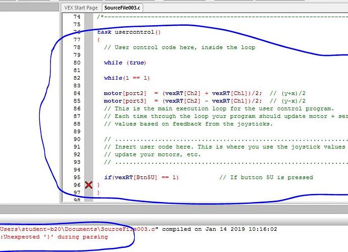

I don’t know what I’m doing wrong why my code won’t compile.
The general form of user control should be
while(true) {
  // some motor commands
The specific error you have is because you have an extra closing } (brace) that does not have a matching opening {
so remove the unnecessary while statement
match the braces in pairs.
