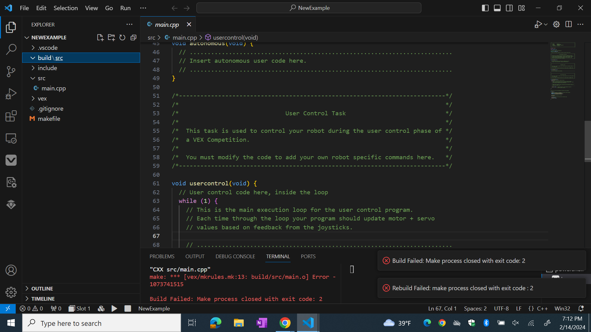

Compile error
in vs vex when trying to download code
Build Failed: Make process closed with exit code: 2
Rebuild Failed: make process closed with exit code : 2
i tried this also on a blank template and got the same error.

In the message it says “redefinition of o”. Is there any information included other than that?
try restarting the the window
i checked the files and there is nothing in the build folder section. its just empty
Can you post the error here? And maybe your code.

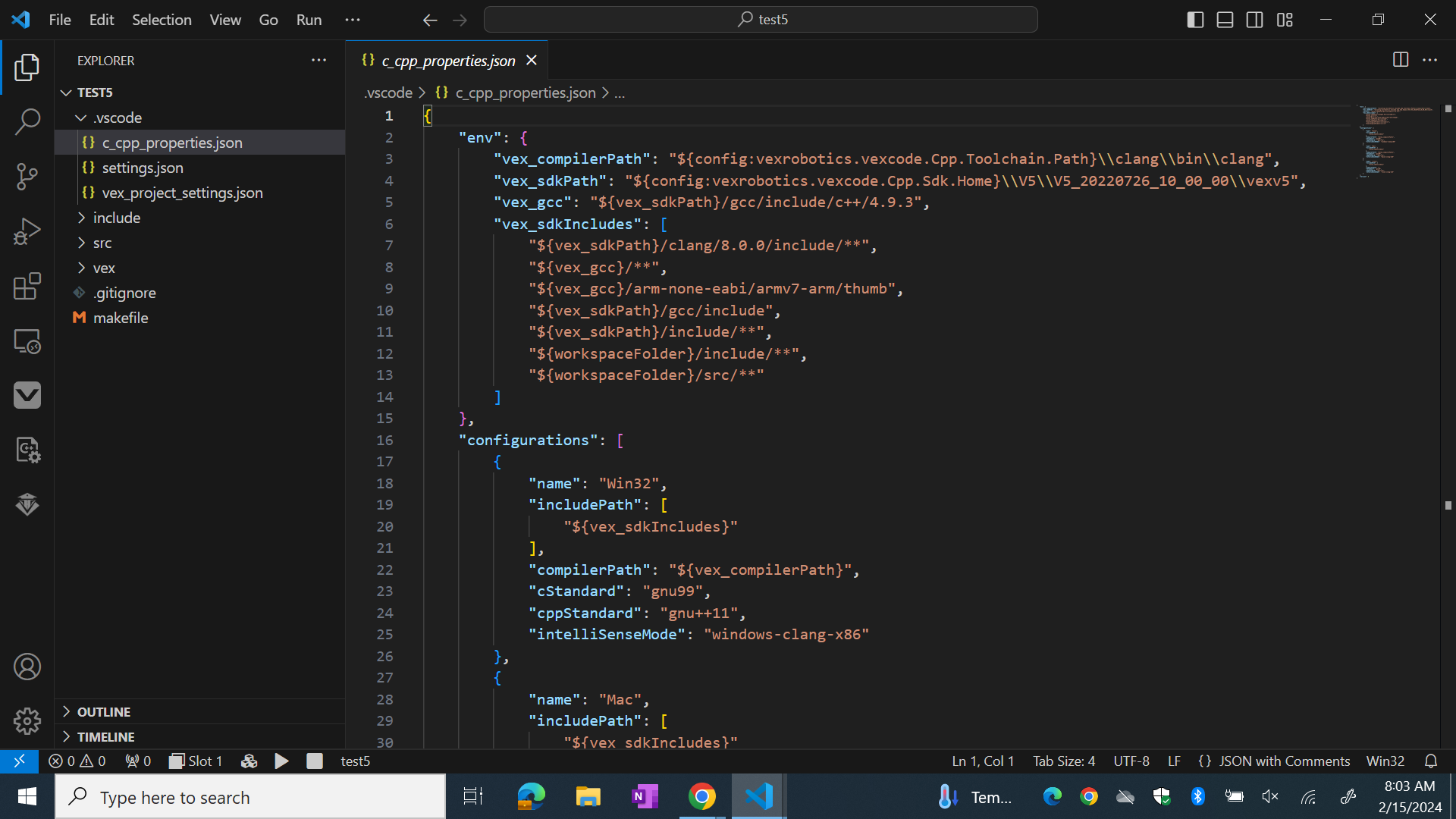

Could you show us your c_cpp_properties.json file?
it’s just a blank comp template and it wont compile
(its in the .vscode folder)

Here is mine
	"env": {
		"vex_compilerPath": "${config:vexrobotics.vexcode.Cpp.Toolchain.Path}\\clang\\bin\\clang",
		"vex_sdkPath": "${config:vexrobotics.vexcode.Cpp.Sdk.Home}\\V5\\V5_20220726_10_00_00\\vexv5",
		"vex_gcc": "${vex_sdkPath}/gcc/include/c++/4.9.3",
		"vex_sdkIncludes": [
			"${vex_sdkPath}/clang/8.0.0/include/**",
			"${vex_gcc}/**",
			"${vex_gcc}/arm-none-eabi/armv7-arm/thumb",
			"${vex_sdkPath}/gcc/include",
			"${vex_sdkPath}/include/**",
			"${workspaceFolder}/include/**",
			"${workspaceFolder}/src/**"
	"configurations": [
			"name": "Win32",
			"includePath": [
				"${vex_sdkIncludes}",
				"${workspaceFolder}"
			"compilerPath": "${vex_compilerPath}",
			"cStandard": "gnu99",
			"cppStandard": "gnu++11",
			"intelliSenseMode": "windows-clang-x86"
			"name": "Mac",
			"includePath": [
			"intelliSenseMode": "macos-clang-x86"
			"name": "Linux",
			"includePath": [
			"compilerPath": "",
			"intelliSenseMode": "linux-clang-x86"
	"version": 4
