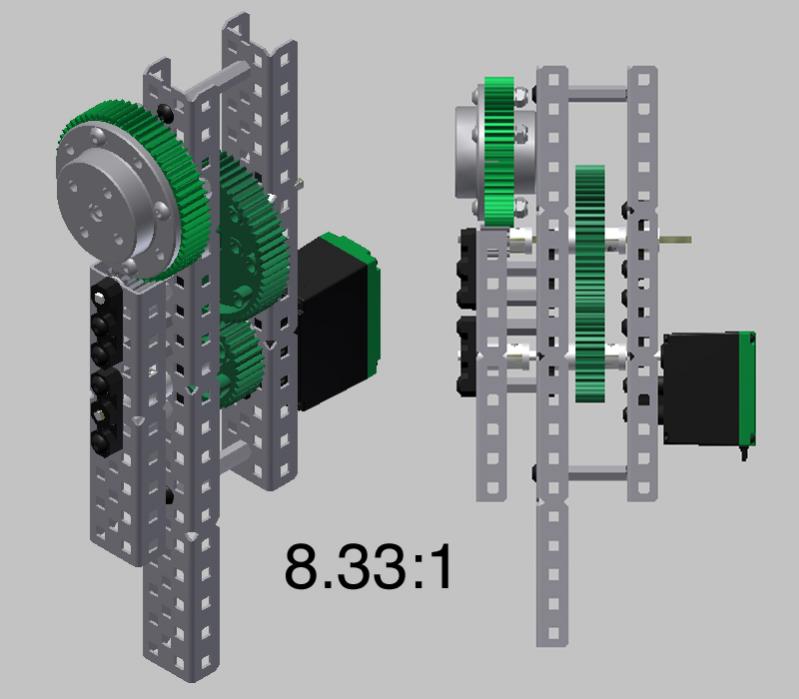

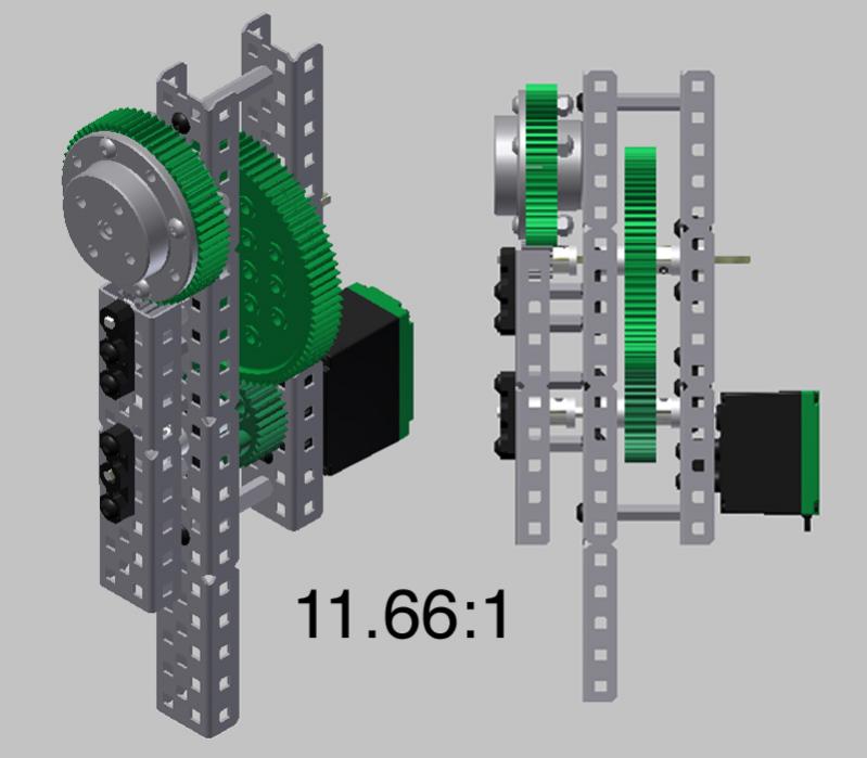

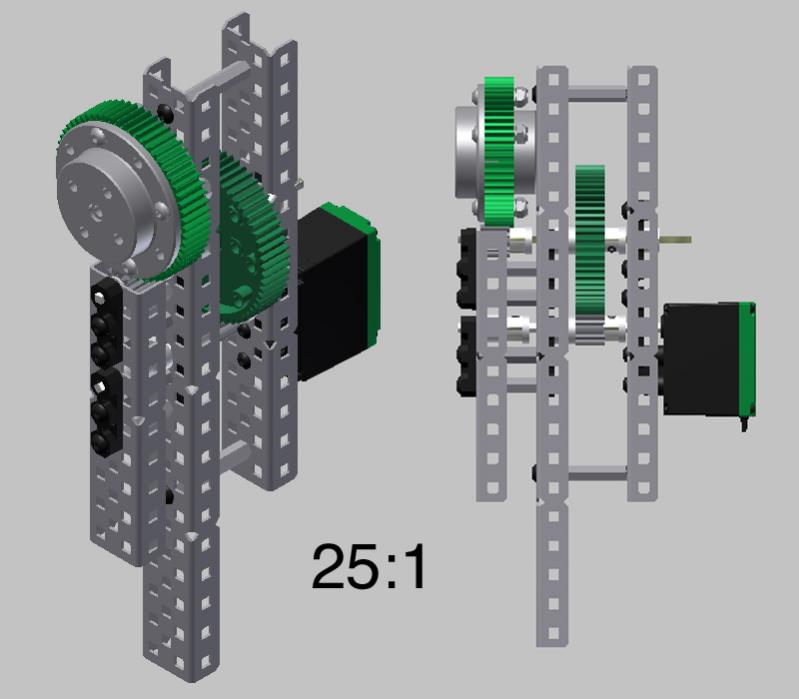

This year one of the teams is working on a design that again uses the small turntable but is flexible in the choice of final gear ratio by simple modifications. Four choices of ratio are available, 5:1, 8.33:1, 11.66:1 and 25:1. The current preferred ratio is 8.33:1 and is able (after preliminary testing) to lift 10 sacks reasonably easily with one 393 on each side of the robot. Here is a partial render showing the compound gearing only, all other structure has been removed.
The position of the motor and also a couple of bearing flat move but otherwise the structure remains the same.

8.33:1, 36 tooth drives 60 tooth, 12 tooth drives turntable 60 tooth.
[ATTACH]6811[/ATTACH]
11.66:1, 36 tooth drives (dual modified) 84 tooth, 12 tooth drives turntable 60 tooth.
[ATTACH]6812[/ATTACH]
25:1, 12 tooth drives 60 tooth, 12 tooth drives turntable 60 tooth.
[ATTACH]6814[/ATTACH]
Edit:
I was showing 15:1, that was incorrect as it was actually 25:1, however, 15:1 should it also be possible using a 12 driving a 36 for the first stage.
It’s best to keep as little force on the axles as possible, so you should always use your smallest gears as early as possible in compound gearing. For example, on the 25:3 ratio, if you powered the 12t sprocket into the 60t gear, then ran the 60t gear over to the 36t gear, which powers the arm, the largest force on any teeth would be only 60% of the current configuration.
It’s best to keep as little force on the axles as possible, so you should try to use larger gears when such large forces are present. Compound gearing yields the same resultant force no matter how you rearrange the gears, so the order does not matter in terms of force on gear teeth.
When considering friction, the order does not matter a lot, but it should still be considered. The energy lost due to friction (between the axle and the bearings) is proportional to the force times the angular velocity (RPM). You will not be able to reduce the friction, therefore, assuming the coefficient of friction is constant and you have a fixed number of axles.
But as you put more force on the delrin bearings, the axle can start to dig in (increasing the coefficient of friction and damaging parts), or the whole bearing can slide so it is no longer centered (both of which I have witnessed). To avoid this, force on gears should be reduced where there is less axle support (the gear is further from bearings or there are fewer bearings). Additionally, you can trade force for angular velocity (RPM) by putting the lesser gearing close to the motor so that the intermediate axle has little force on it and instead is turning faster.

That design was notorious for twisting the axle, the students had to swap out one side or the other at almost every competition. So we tried to learn from our mistakes and take that advice.
There were many other design considerations leading to the example I posted yesterday including some that are physical. There was a significant advantage in the 12 tooth gear being smaller than the dimension of the 1x2x1 C channel as it allowed parts to be directly attached to the turntable without further spacing.
Our experience to date suggests that keeping the torque that an axle experiences lower is more important than the forces on individual gear teeth.

Oh thank you for pointing that out to me. It turns out my previous post on this thread was incorrect (it is fixed now). I can’t recall twisting an axle, because we always screw directly to our arm and don’t use compound ratios. The configuration you posted yesterday is better for preventing axle twisting, and would probably be the best way to do what it’s trying to do (without using larger gears).
Thanks for updating your post, I’m not a mechanical engineer and don’t have the experience with mechanical engineering that I have in other areas, however, the way I always look at this is as follows.
The spec for this design is to run the motor with around 5 in-lb of torque so as to keep the speed of the motor at the optimum point, if we used the 1:5 ratio first then the next stage would be providing 25 in-lb of torque. This torque would have to be transferred through the axle to the gear driving the turntable. With the arrangement I used the 3:5 first stage only places 8.33 in-lb of torque on the axle which therefore has less chance of twisting.

We want to reiterate the thanks as the compound gearing certainly helps with issues we had over the weekend with a raised arm backdriving under load. The gearing using high strength gears (25:1) though takes about 2.5-3 seconds to lift to the trough (using 2 393 and heavy elastics. This replaced a 5:1 sprocket which had no problem lifting in 1-2 seconds. We know the sprockets generally are more efficient; but before we rebuild with sprockets either 25:1 or eventually 15:1, is there an opinion on whether it will be as effective on the backdriving issue?
