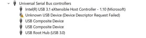

I am trying to connect a Vex V5 brain to my computer to program it using a wired USB connection but when I connect it to my computer, it makes the connecting sound but I am still unable to connect to the brain. I tried using a different brain, and a bunch of different USB cables, (my computer did not even make the noise with any other cables other than the original one). I tried uninstalling VexCode Pro V5 and reinstalling it, and I have also checked to see if the drivers are installed correctly (they are). Here is what it shows on Device Manger:
I have no idea what is wrong and would appreciate any help. This is my first time working with anything Vex related and I have tried everything I can.

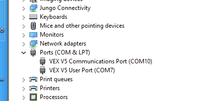

What does it show under “Ports” in the device manager ?
What OS are you running ?

With another cable, my computer doesn’t even make the noise of a usb port being connected.
I am using Windows 10
You should see this if the V5 is connected. Until windows detects the V5, VEXcode will not be able to connect.
So the issue could be a number of things.
Drivers not installed correctly.
Bad cable.
Broken USB port on the V5. (try another brain)
Broken USB port on the computer. (try another computer)
The USB port on my computer works just fine with other devices, and the cables work fine too. I am pretty sure all the drivers are installed correctly, so I am going to try using another brain. Unfortunately, I won’t have access to another brain until next week, so I can’t do much now.
