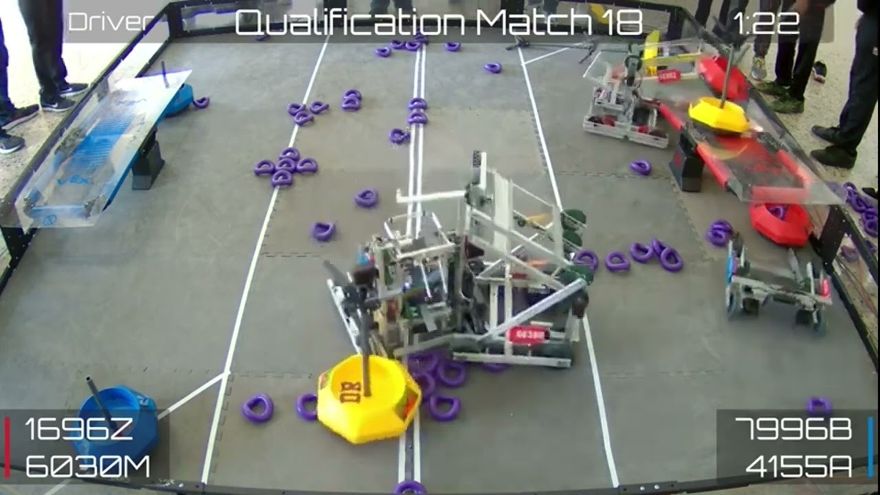

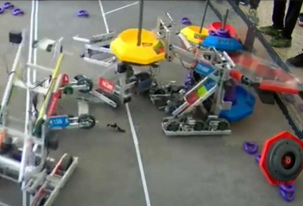

Sorry to revive the thread, but This happened at the competition I was at
We got disqualified because the opposing alliance said they were trying to balance a MOGO on the platform but we were in the way. The refs didn’t see the whole situation, so it came down to our word vs there’s. If they could see the replay they would see that they didn’t have a MOGO and didn’t pursue a MOGO untill 20 seconds after. The event was streamed, and this is their video, and it could have assisted a lot in the ruling.
This was a qualification match, so it really doesn’t matter, but is a good example of where it can help.
I am confused. I didn’t see any rule violations in this match. Your robot didn’t event enter the opponents home zone; did you by chance upload the wrong video?
oops, yes
should be fixed now
You were.
https://www.robotevents.com/VRC/2021-2022/QA/880
No they weren’t.
The picture clearly shows that the red alliance has no goals in their possession, they aren’t actively trying to score point.
With this thread has been brought back up and the February game manual update approaching, I was wondering if anyone from the GDC (@Jon_Jack) would be willing to say what they think about the stuff that has been said so far in this thread.
would look that there is physical contact by Blue and contacting Red (irregardless of possession of mobile goal possessions - interfering) and Red prevent from movement with other Blue team member in contact… … and mobile goals near platform that would could swing score …
Seriously - this is not a great example still image to illustrate situation in last 30 seconds - if red was moving and blue is all contact with both robot and platform …
Now ask me why I did not watch video - why? match is over.

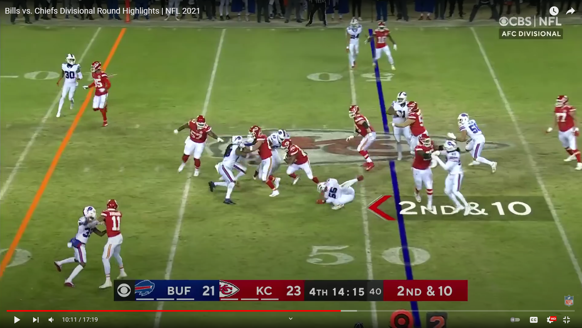

Here’s an example of what I’m talking about from the NFL and NHL (sorry if there are any Cowboys fans reading). Notice how many angles whoever is doing the video review can use to determine if a call should be changed. Video review isn’t done with a single full field angle.
In fact, in recent years, professional sports leagues have moved to placing additional replay cameras inside the field of play (pylon cameras in the NFL, overhead goal cameras in the NHL, base cams in MLB, etc). These give reviewers even more angles to closely examine the play and make the right call.

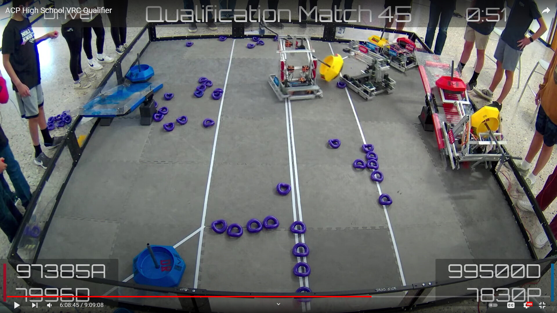

Let’s pretend Tipping Point has a possession limit on the number of Rings your Robot can hold. One of the robots in the top right corner of the image you posted above is possessing more than they’re allowed, and this happens to be a match affecting violation.
Can you tell me, with 100% certainty (and don’t forget, within a reasonable amount of time, because this decision is now holding up the rest of the event) exactly how many rings the two robots in the top right corner are holding?
Time to start counting the number of visible rings :smiley:
Edit after counting all the rings I could see(and messing up at least twice) those robots should be holding 24 rings

Zero. They are holding zero.
Now, I assume you also mean rings in the corner that access is being blocked to and therefore “possessing”. Firstly, the red robot is being pinned by the blue robot which means that if a violation is occurring it’s a forced violation, so no penalty should be incurred.
But let’s say they’re on the same alliance. Then the answer is around ten. Which, unless I’m forgetting the rules of a game, is more than enough to DQ under any previous possession rule. And frankly, if you have designed a game where the possession limit is ten, no live referee is going to be able to count that quickly and determine whether it’s 9 which is totally fine, or 11 which is a DQ, so the problem is that the game rules are impossible to enforce.
