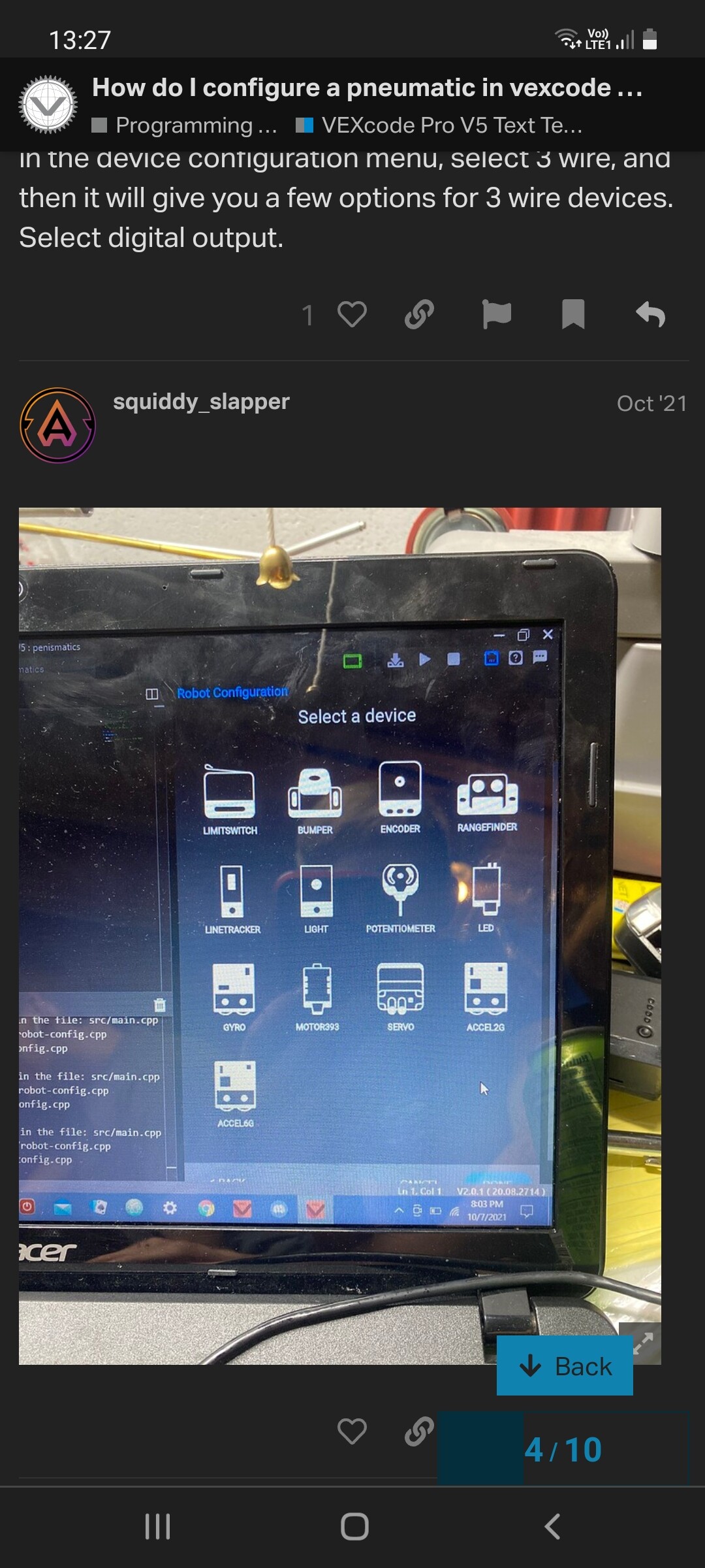

I don’t have that option on my version of vex code pro v5. Do I need latest version?
Check under the “3-Wire” category.
I don’t have digital out.

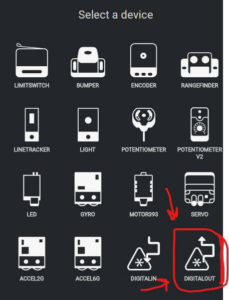

Mine looks like this
This is what mine looks like in VEXcode Pro v5 (digital out circled):
You might want to double check that you have the newest version as a starting point. Unless there’s something strange with the brain selection, I would think it would be on there otherwise.
