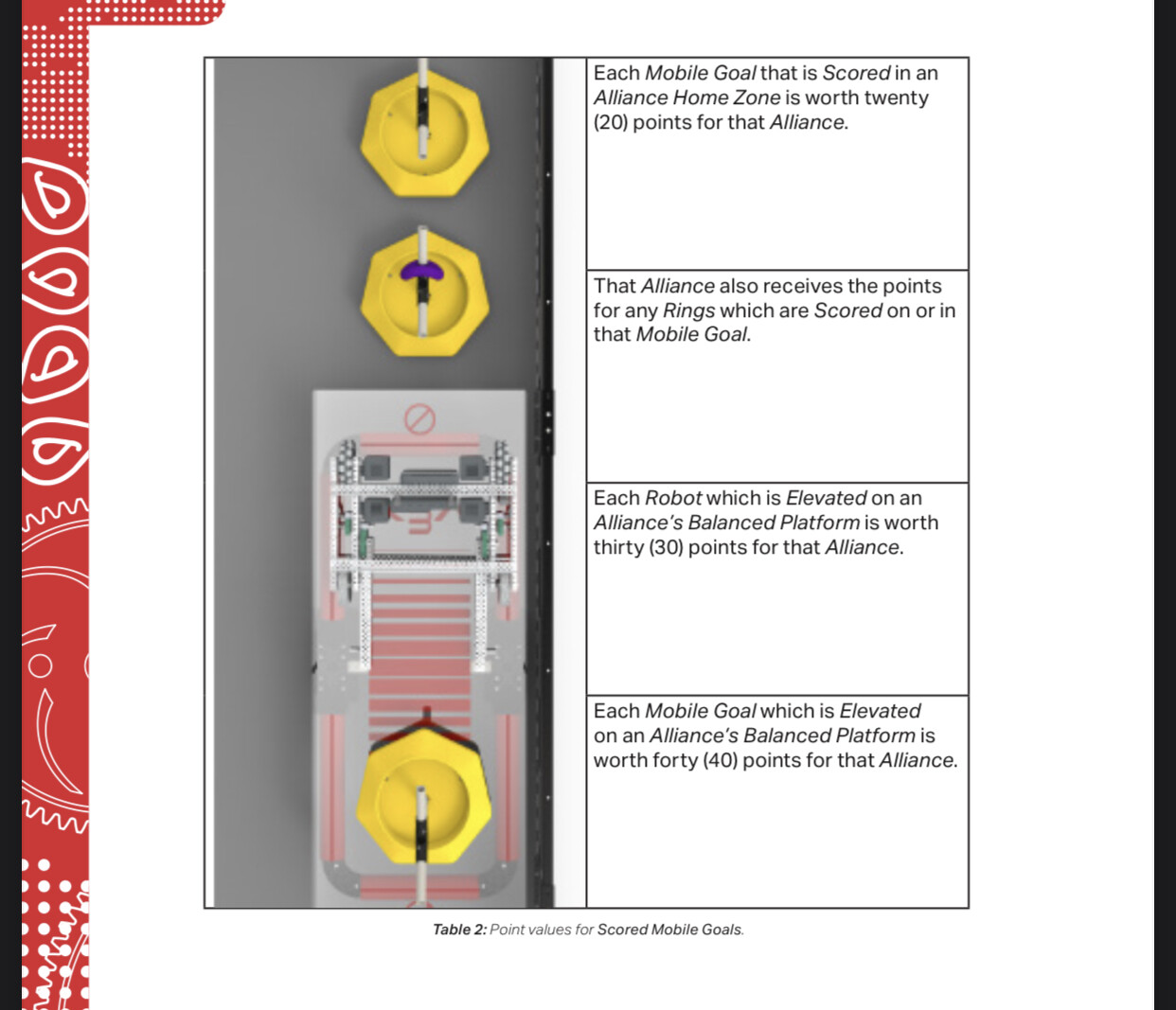

You would be allowed to do this, but as stated in the game video, the rings on an alliance goal will be scored no matter where it is on the field at the end of the match.

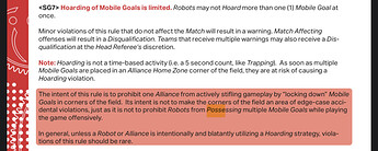

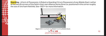

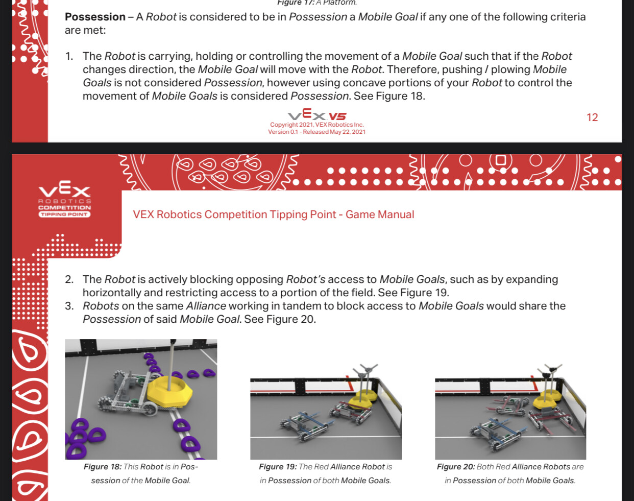

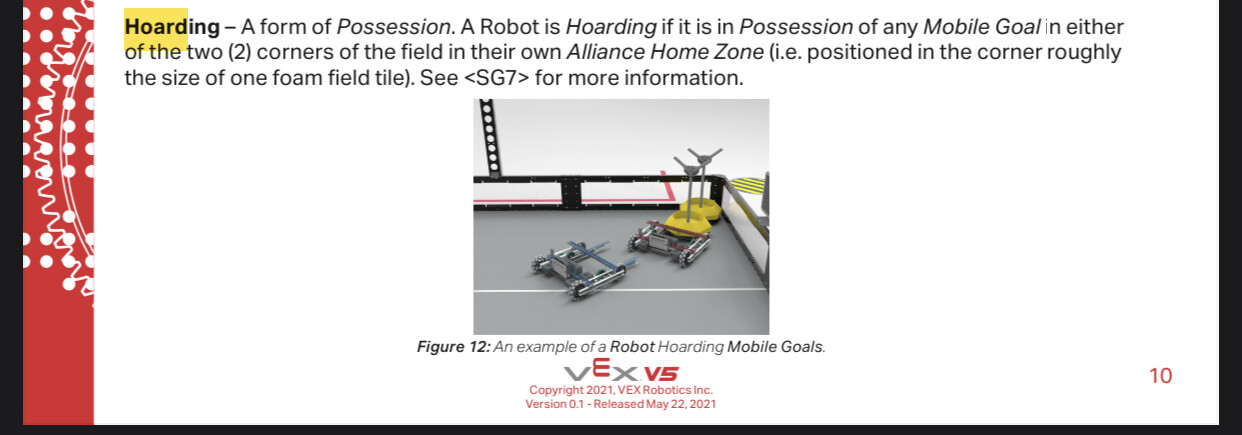

I believe it is legal to be in possession of an opposing mobile goal. I believe you can, in fact, possess as many mobile goals as you want regardless if it is your alliance’s or not. But you are not allowed to hoard more than one of any mobile goal on the field on any of the two corners on your alliance’s side.
image image
Simply put, chances are yes that what you said is legal such that you move the opposing mobile goal out of their zone to cause the rings not to be counted on the scoreboard.
