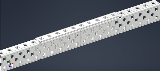

Connecting 2 short c channels to make a long one
How would I connect 2 c channels to make one long one? Our team is low on supplies so it isn’t possible to just buy a longer one, what piece should I use to connect them? and should I use pop rivets or screws?
I would like to not use channel couplers since we don’t have them, I’d rather use something else.
U-channels are effective at connecting c channels. You could also use lock bars I guess
okay, I’ll use lock bars
Here is one way to do it, which will work if you are using the channels as a brace or something:

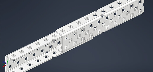

However, if this is for something else, you might be better off with something like this:
