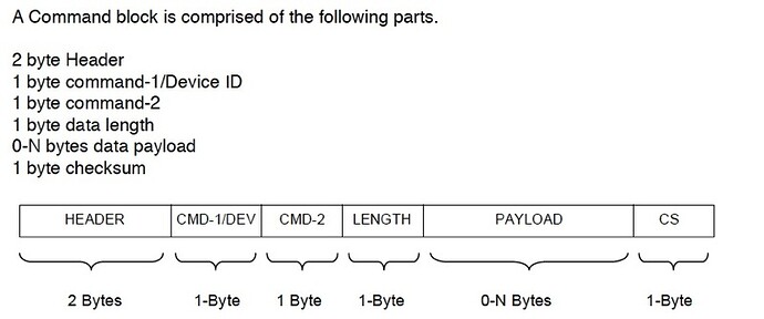

Hey, so i was wondering if there was any possible way to bridge two VEX cortexs. Im running low on motor ports so I’d like to be able to bridge the two and see to it that they are semi-secure.

So you can send messages back and forth with UART fairly easily.
Any idea how to connect Uart and how to program it?
See this.
https://vexforum.com/t/communicating-between-two-cortex-dual-cortex-robot/24236/1
O wow I had completely forgotten you had done that one. I was going to offer to spend time tomorrow putting code together with a pair of borrowed cortex’s. You just seem to have conquered every topic at some point or another. :slight_smile:

That P3 protocol you mentioned in that thread seemed very cool. Wanted to try it but never did. A restful or JSON parser would be cool too as the phone bluetooth comms like that.
