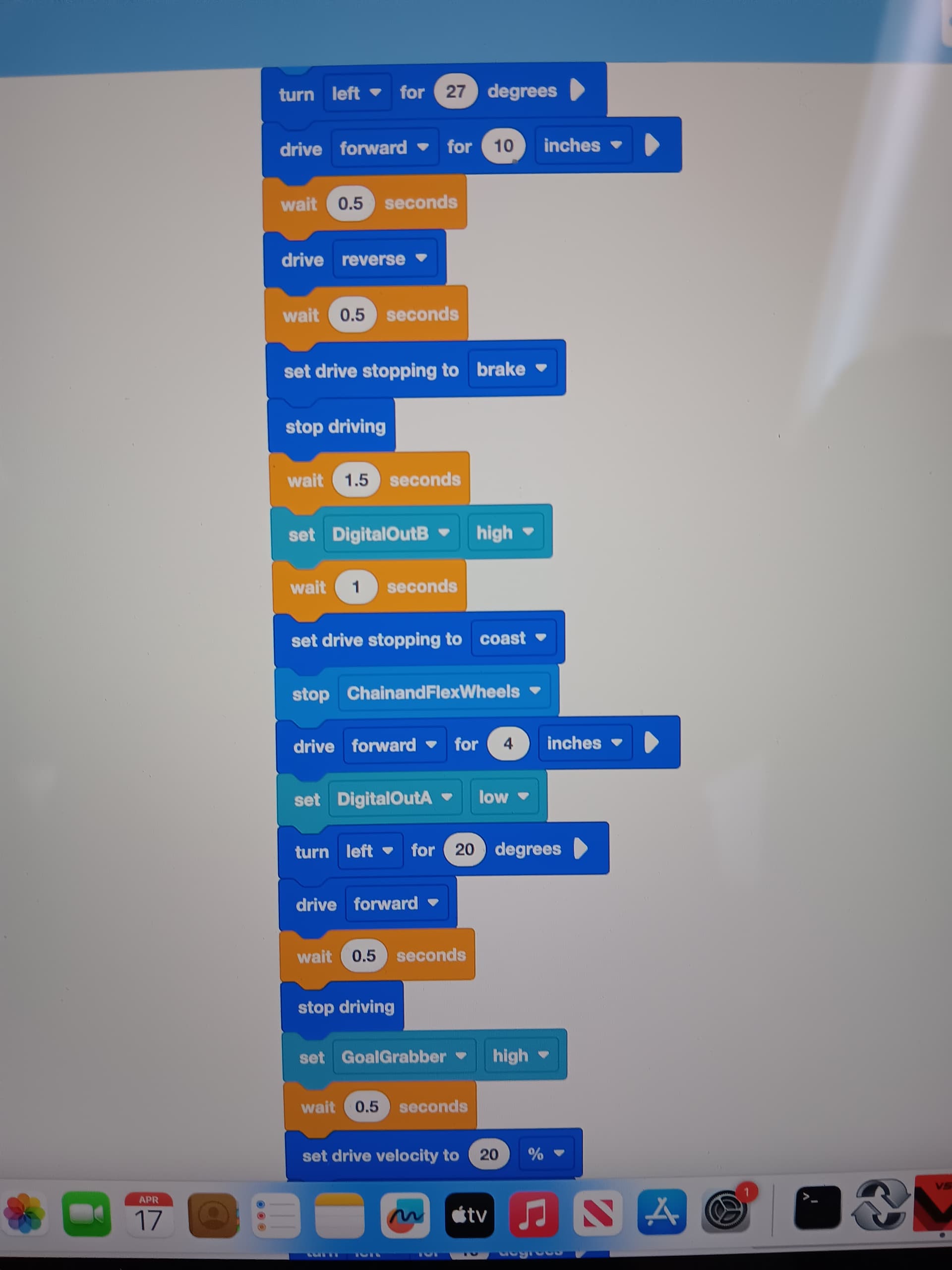

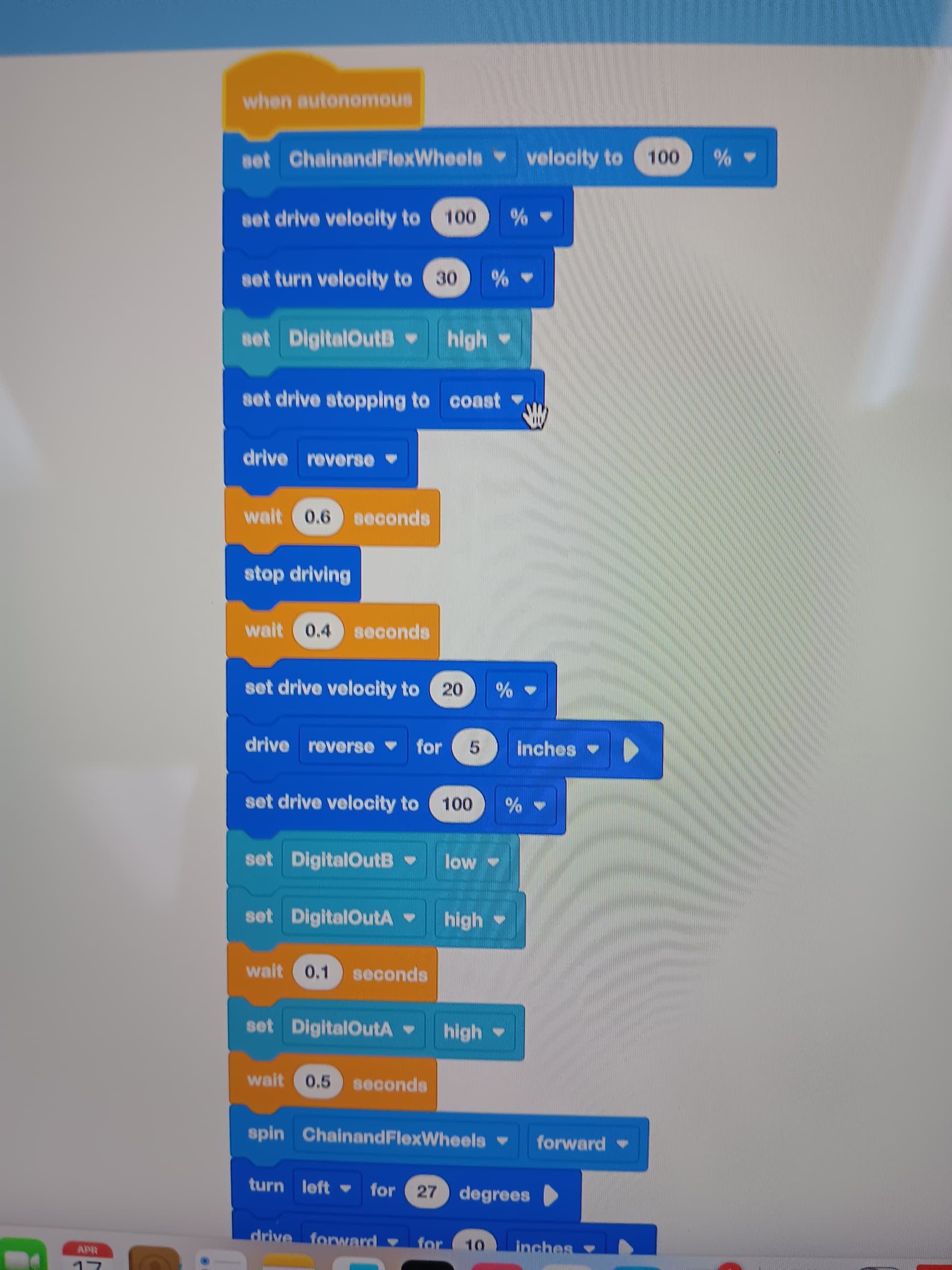

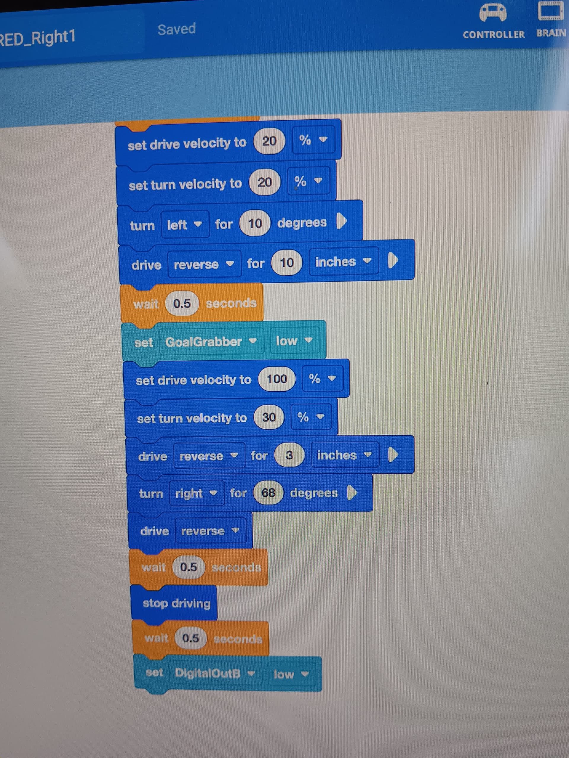

Can someone take a look at our video and code? Why isn’t it not being consistent? It doesn’t place both rings on the mobile goal everytime. Sometimes the second ring gets stuck.

Other than that though, your auton code looks pretty normal. If you’re having trouble aligning with goals and stuff, try slowing down your turn and drive speed.
Usually when autons without sensors fail it’s because of very minute inconsistencies in the setting up of the robot (being slightly too much to the left, a few degrees clockwise, etc). Videos (plural) would help greatly with this.

That situation does seem like it can be mitigated with tuning that turn angle, slowing down the speed, or having the robot pause for a second or two before it clamps.

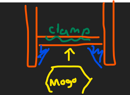

I would also reccomend making that mogo clamp more consistent - probably by adding more c-channels to increase it’s clamping width or by adding funnels.
Going off what @Gigahertz.t said, If you add a few wait commands, it should work fine. Especially when grabbing the second goal, add a wait commands between each command. When you grab the goal with your MogoMech, it is still moving because you moved back while letting go of the goal with your doinker, causing it to shake and not grabbing correctly. Hoped that helped! :slight_smile:
We’ve modified the mogo clamp a few times already. Adding c- channels to increase width. We can try that. Not sure what you mean by funnels.

I believe @Gigahertz.t mean guiders when saying “funnels.” You can add either a small piece of metal, plastic, or even a screw with spacers, so the goal can roll/slide into the same place every time.
Polycarb plates or some standoffs in a roughly triangular shaped manner that “funnel” mobile goals into the mogo clamp in the correct desired position (the blue areas)

I think that an aligner can probably solve that problem. Another solution would be an omni clamp. I think aligner would be a little easier but can be jank sometimes, and most bots use omni clamps so it wouldn’t be that hard to find a design on Youtube or something.
