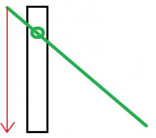

Easy solution to the gravity thing:
[ATTACH]9020[/ATTACH]
Have whatever constant-force spring device you use attach to an extension of the arm sticking past the pivot point, mounted vertically below it (it’s not exact as the vertical-ness of the rubber band changes, but it’s pretty darn close).
I’m not quite sure how this mechanism works. If you could explain a little more that would be great.

I just thought it out logically. When the rubber bands are fully stretched, that’s when you want the acting angle to be low, and as the rubber bands become more slack, the acting angle should become greater. I just found the corresponding mounting point that enabled that function.
