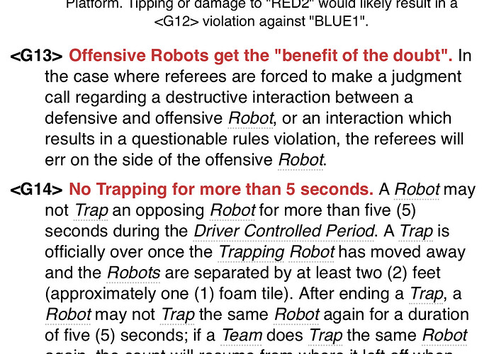

Defense is legal but when the refs have to make a call, they are told to call it in favor of the offensive robot when in doubt.
<G14> No Trapping for more than 5 seconds. A Robot may not Trap an opposing Robot for more
than five (5) seconds during the Driver Controlled Period. A Trap is officially over once the Trapping
Robot has moved away and the Robots are separated by at least two (2) feet (approximately one [1]
foam tile). After ending a Trap, a Robot may not Trap the same Robot again for a duration of five (5)
seconds; if a Team does Trap the same Robot again, the count will resume from where it left off
when the Trapping Robot initially backed off.
trapping is defined as
A Robot status. A Robot is Trapping if it has restricted an opposing Robot into a small,
confined area of the field, approximately the size of one foam field tile or less, and has not provided
an avenue for escape. Trapping can be direct (e.g. pinning an opponent to a field perimeter wall) or
indirect (e.g. preventing a Robot from escaping from a corner of the field).

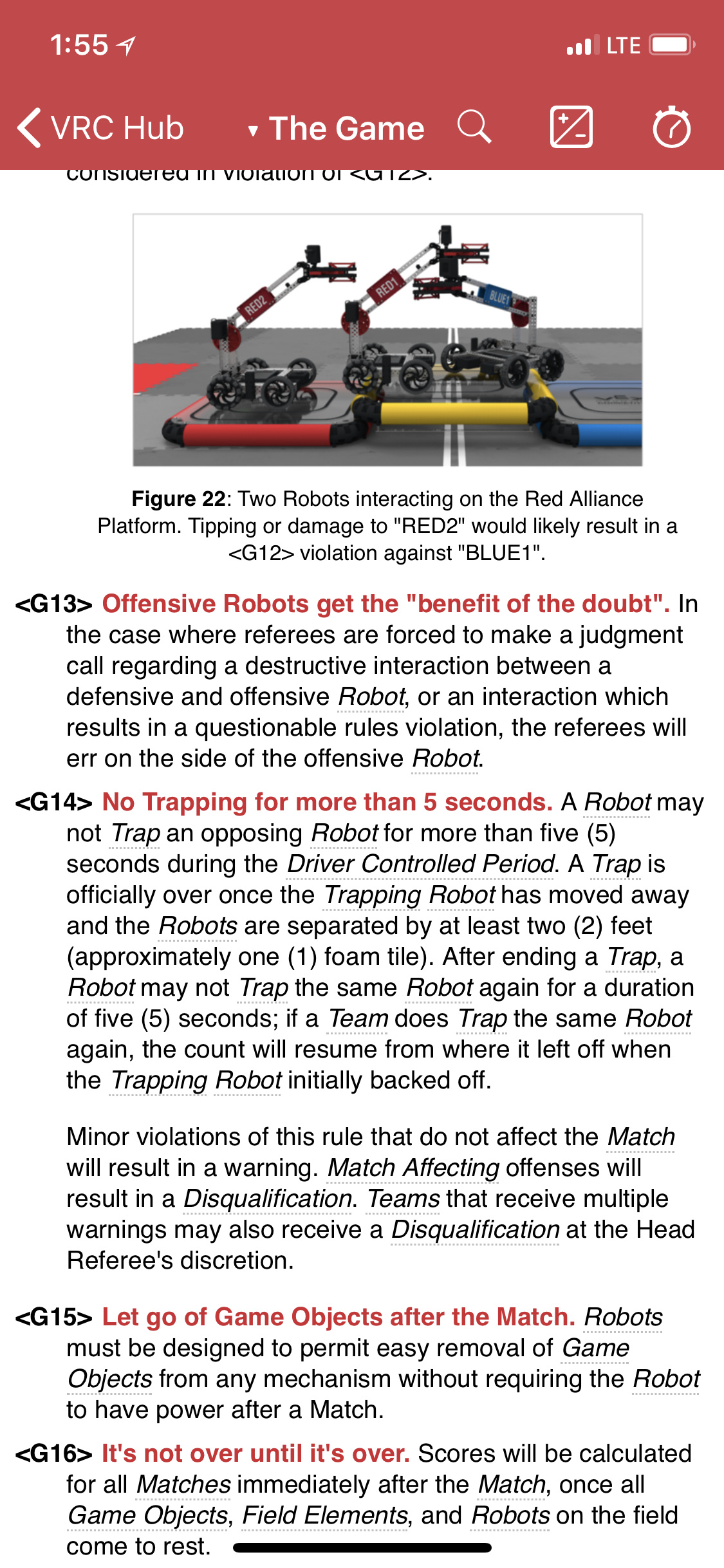

<G12> Don’t destroy other Robots. But, be prepared to encounter defense. Strategies aimed
solely at the destruction, damage, tipping over, or Entanglement of opposing Robots are not part of
the ethos of the VEX Robotics Competition and are not allowed. If the tipping, Entanglement, or
damage is ruled to be intentional or egregious, the offending Team may be Disqualified from that
Match. Repeated offenses could result in Disqualification from the entirety of the competition.
but this extra part to g12
VEX Robotics Competition Turning Point is an interactive game. Some incidental tipping,
Entanglement, and damage may occur as a part of normal gameplay without violation. It will
be up to the head referee’s discretion whether the interaction was incidental or intentional.
basically says it’s the refs’ decision

Here is the rule
im aware of the rule
