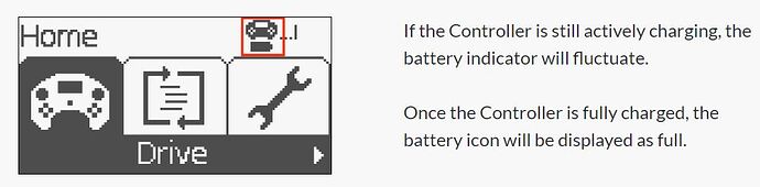

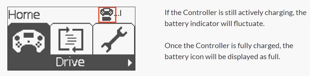

How can I tell when the vex v5 controller is FULLY CHARGED? Is there an indicator?
Welcome to the forum, please do not revive threads that are over a year old, it is better to ask the question fresh.
The information you need is in the library and can be found at this link.
