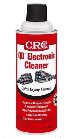

This stuff is safe to use on the whole thing while it’s open. It’s not a replacement for water/alcohol, but it is a good general purpose cleaner for the circuit board, switches/sensors, etc.
