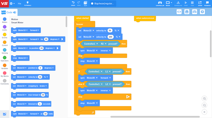

I recently moved my brain to help stabilize my center of gravity, and just learned how to download more than one code on the brain. When I downloaded the second code and started remaking it, the controller no longer connects to the brain on either of the programs. I haven’t completed rewiring all the motors, but it shouldn’t stop the controller from connecting. Why would this happen?
Here is the code I have so far.

Is the radio (the piece with the wifi symbol) connected to the brain because that is the way that the controller connects to the brain?
I’m so dumb, thx so much
