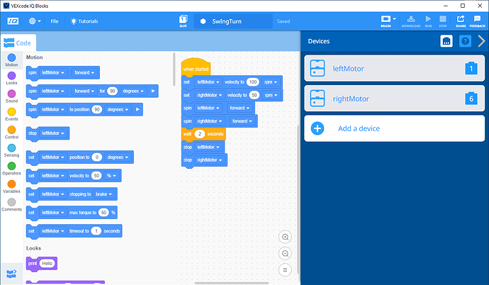

Once a Drivetrain has been configured, we cannot find any way to control those Motors individually.
If we want to make a swing (wide) turn, but the Drivetrain is configured, how do we do this?
Thanks

I don’t know how to code IQ, but I bet you could make a swing turn by driving forward and turning at the same time.
I think you may have to manually program your steering instead of configuring it in the set up

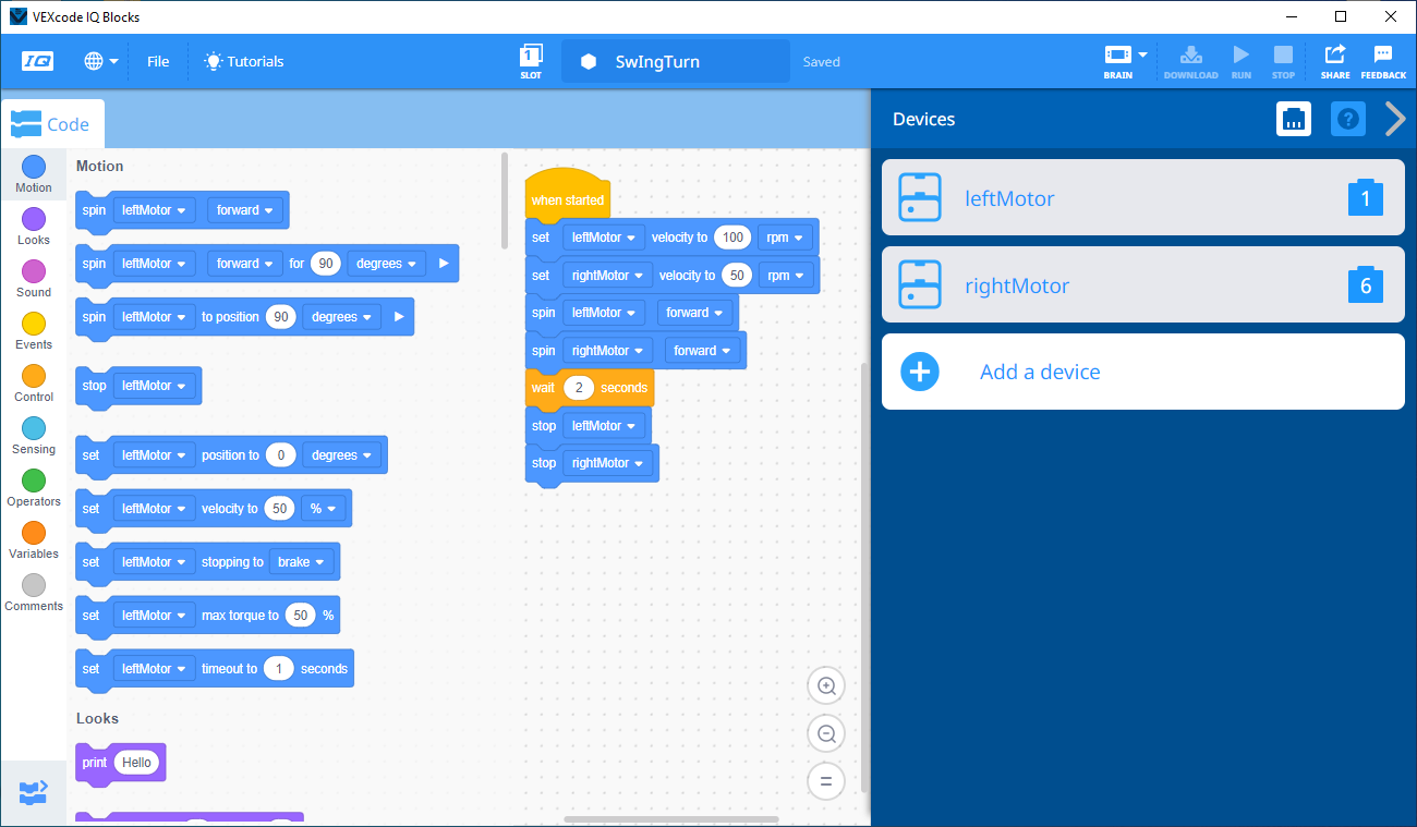

I don’t think you can do this using the drive train commands as it stands. You would need to calculate these manually using individual motors rather than the drive train.
For example, this would work for a swing turn but it is based on time movement rather than a specific distance.

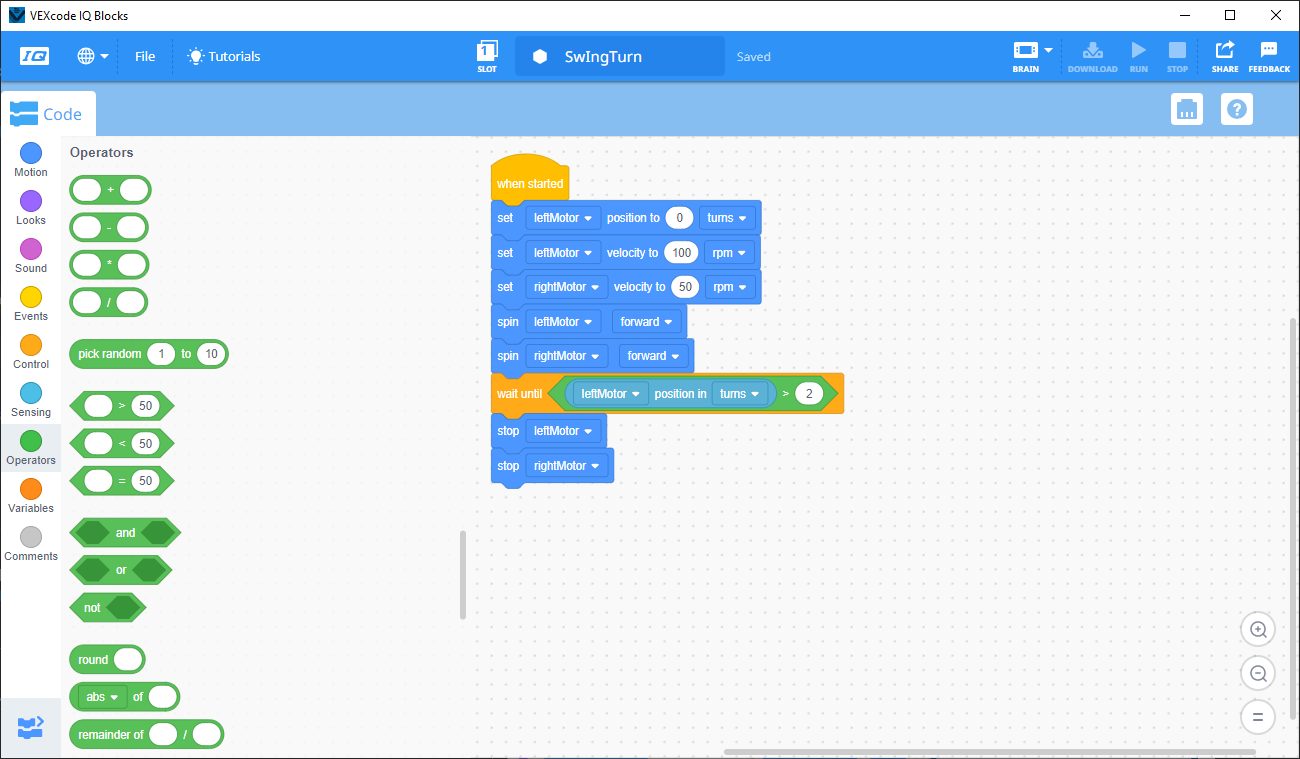

This version would do a specific distance of the outside wheel of the swing turn:
Just be careful not to use = in the “Wait Until”, use >. I guess the motor encoder value is a double behind the scenes so is never exactly = 2.
