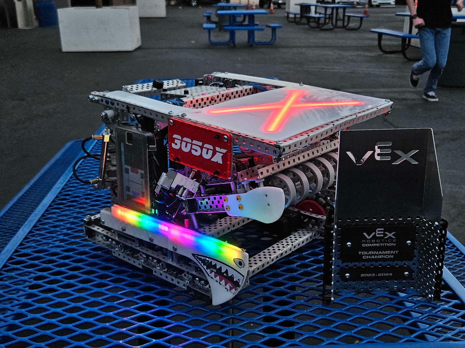

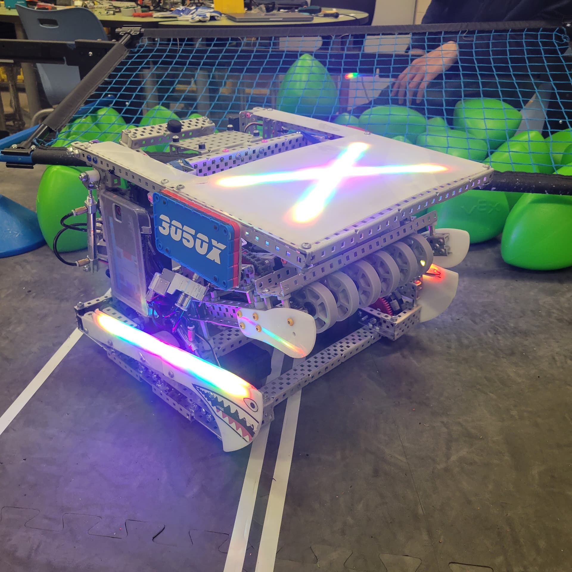

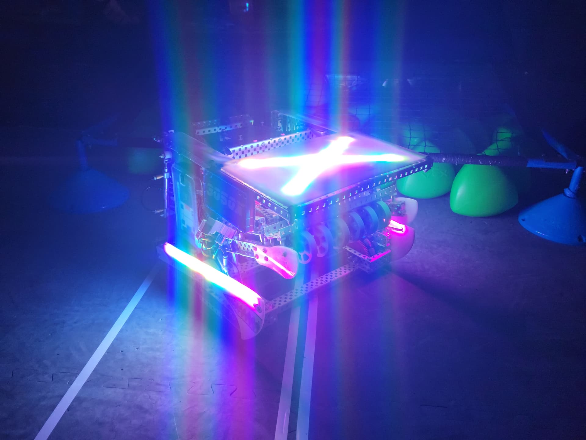

Here are some examples of my team using LEDs last year

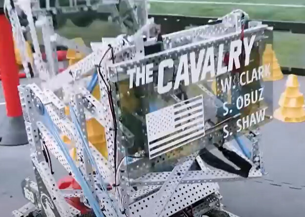

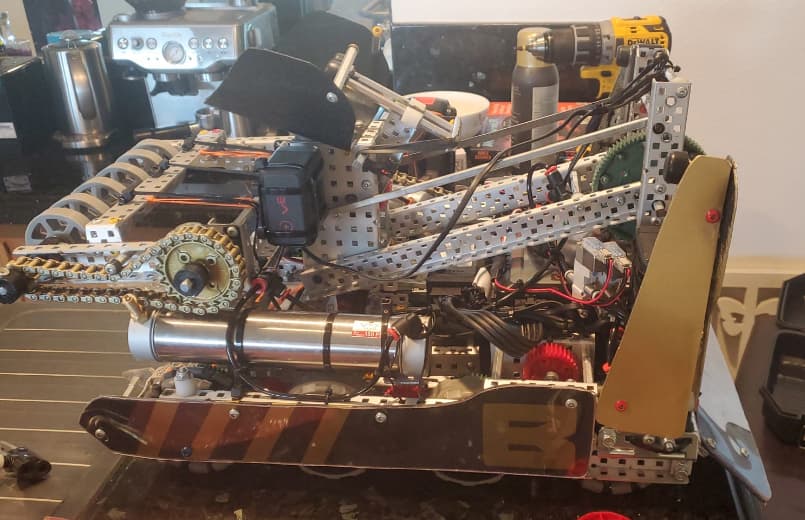

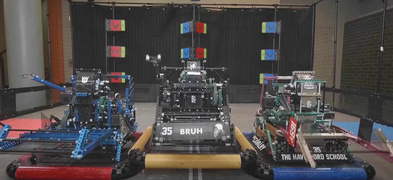

This is a pretty good example of decorational sideplates I did for one of the bots I built last year.

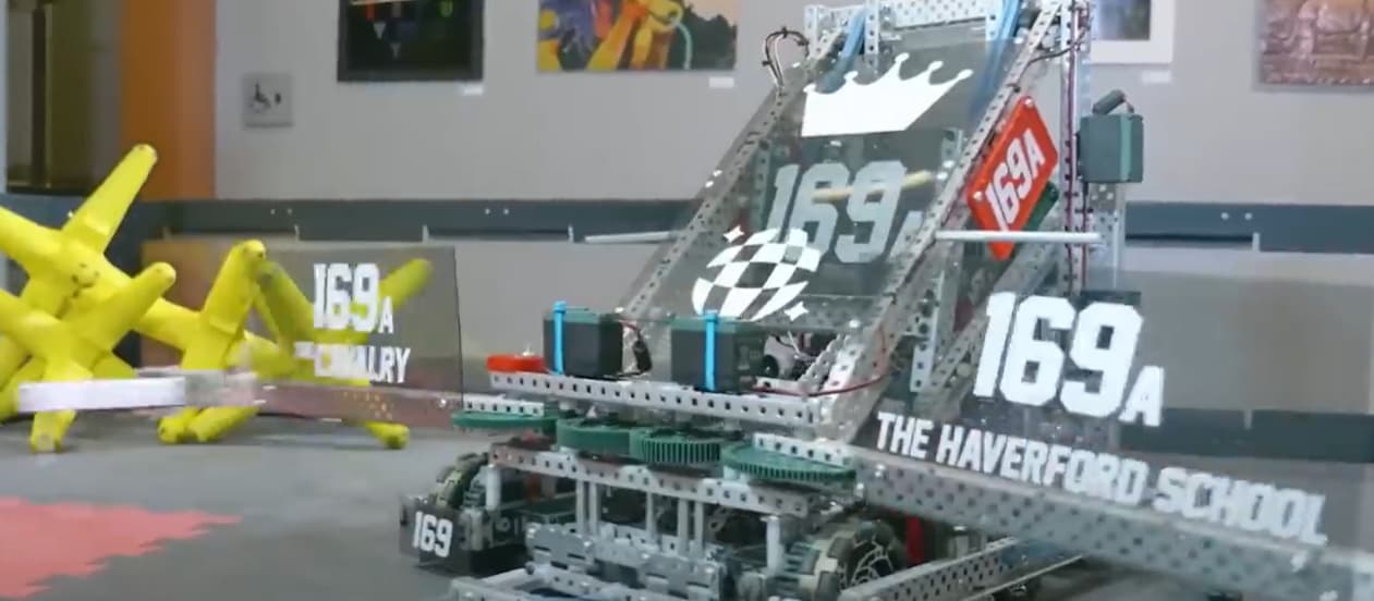

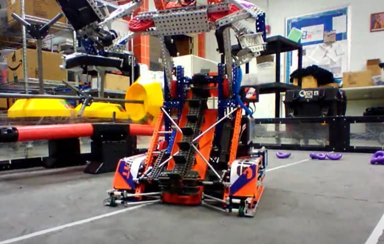

Thanks for the submissions, do you have higher quality versions of this? Some of these seem to be a little desaturated.

I like this, is there any other description you’d like to add to this image (techniques you used, stuff you did in the process, tips and tricks)?
Thanks a ton :slight_smile:
Love the LED Usage!
Any tips or tricks you’d like to add to these images? (especially since these need to be coded).
Appreciate the submission :).
For the sideplates, we cricut cut vinyl stickers out of gold, in the shapes we needed. We then placed them on cut precolored polycarbonate pieces, in this case black, and put identical, decorational transparrent polycarb over it and screwed it together to protect the cricut stickers. Its a bit heavy but the pattern is 100% permanent;
All credit given to sylvie for this amazing guide: Addressable LED Control on the V5 | sy1vi3 and using sylib simplified the coding alot.
sorry its from reveal videos so i cant really get better quality ones
