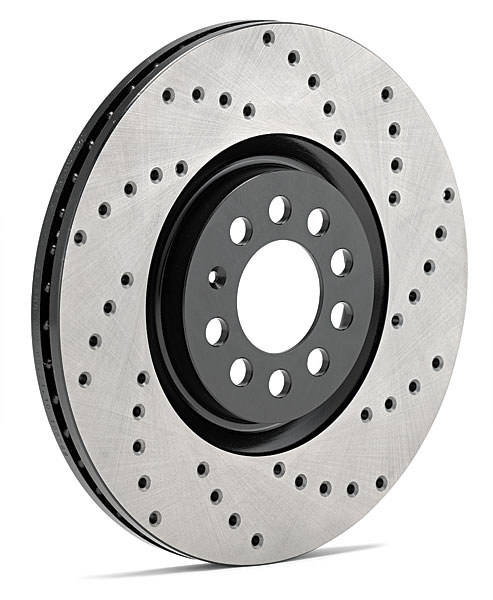

I like this solution a lot. It reminds me of drilling holes in brake rotors on sports cars to cool them.
+1 to vent holes!
http://www.tirerack.com/images/brakes/search/large/stoptech_crossdrillrotor_l.jpg

Which IIRC actually has no effect at all, it’s just cosmetic, I need to try and find the tests one of the motoring magazines did a few years ago.
Insert my picture into here… :facepalm:
OK, the vents in the brakes help with the heat more than the drilling… Sigh. Do spinners not help the wheels either? :smiley:
