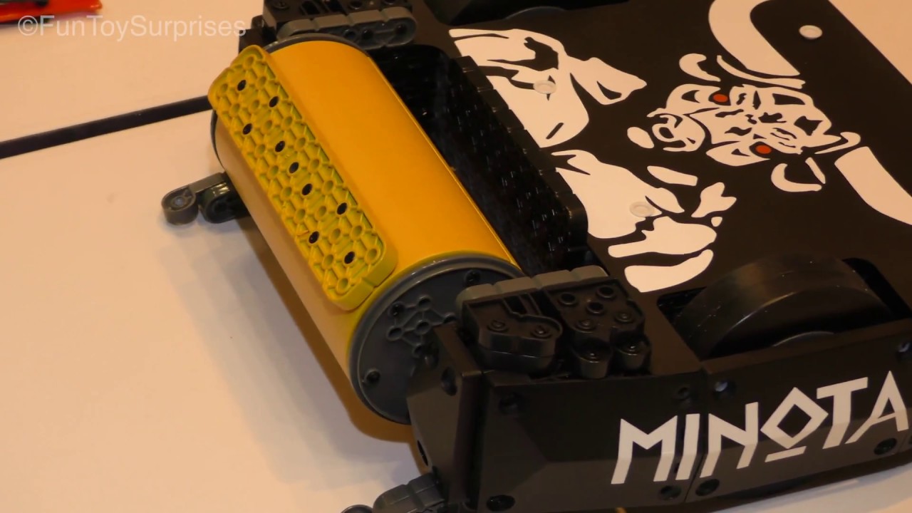

In my experience, the Hexbug kits are a great source of mechanical ideas for VEX IQ. Not all of the parts transfer completely, but some of the ideas are pretty epic.
They are! I have most of them and have built the ones that I have. Some survive to be models, most end up as parts. The front loader scoops made pretty good holders for ball in this years game.
If you want your kids to learn some additional mechanisms directly from Vex parts, I suggest them look into the Hex Battlebot replicas. Definitely shows what possibilities are with vex parts. The kids I mentor get a lot of ideas from these.
