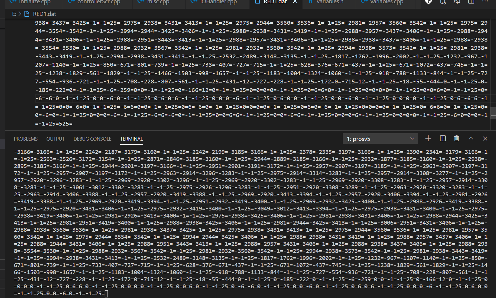

@weilin Yes I have read the documentation for the microSD card. The SD card is formatted with FAT-32 and /usd/ is also the first part of the string. I’m able to write and read files fine, doing it in this function seems to be the problem.

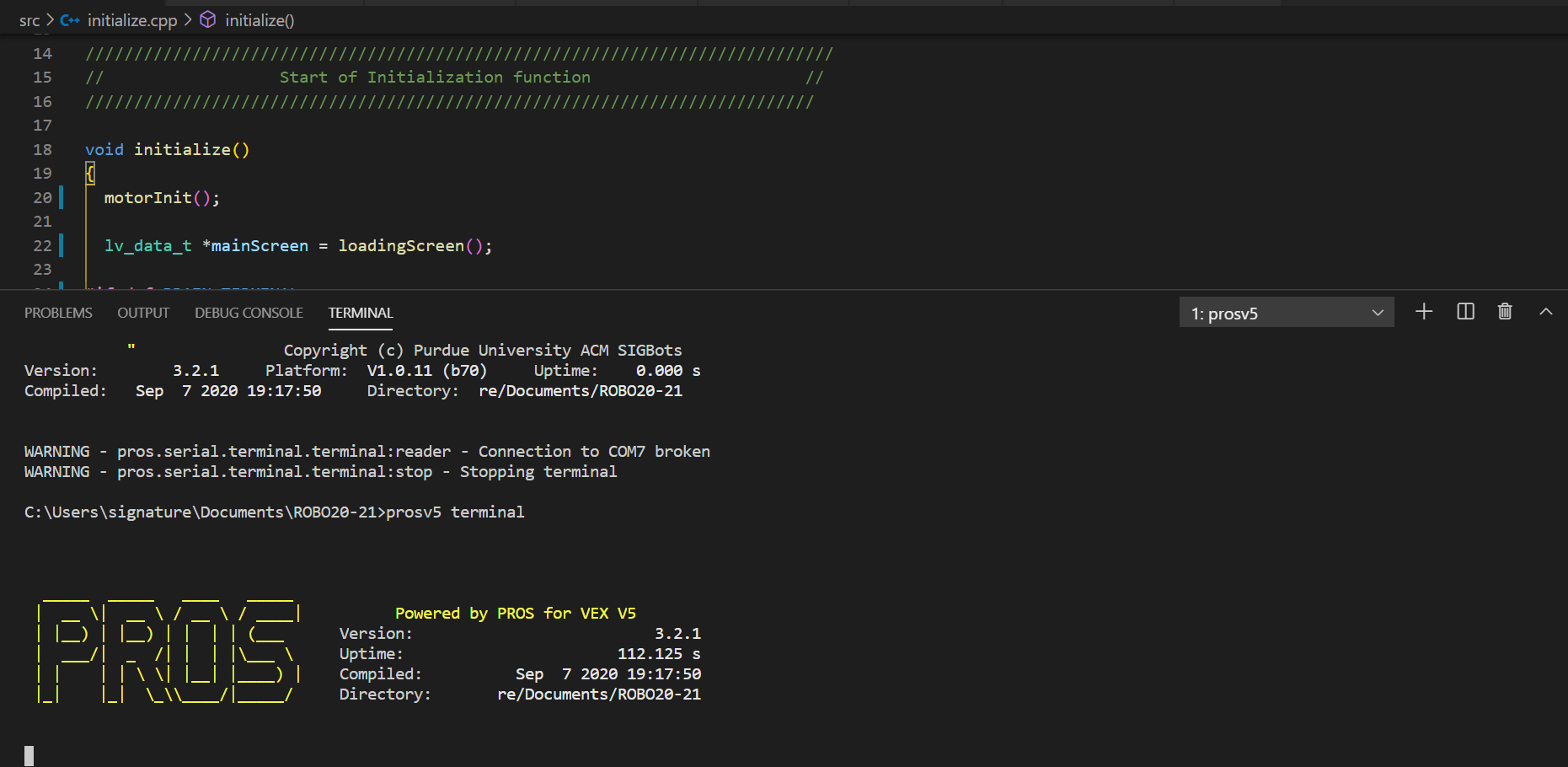

@weilin I just tired to debug through the PROS terminal but nothing was displayed. The program still runs after the function completes, just no data is written to the write file that is created. Also, the files are not in binary. I would also like to stick with using C file I/O as well.
Untitled (2)
Is there any other factors that could cause the file to be created but not written to?
@weilin I just discovered what the PROS terminal is and how to use it, I probably wouldn’t have bothered to make a makesift terminal on the brain screen if I knew about this beforehand. Anyways when I print the data that is read from the readfile it doesn’t show all the data in the file. This is very odd because the Brain “console” shows all the data.

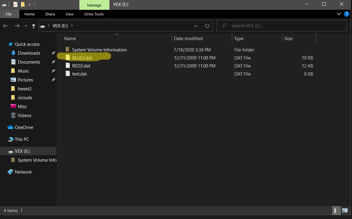

I also just created the file highlighted in yellow with my write function, just as a sanity check. Then tried to copy this file and still got the same result.
The only noticeable difference in the function that writes data is that it uses a call to “fputs()” instead of “fputc()”, which I doubt would make a difference.
Update: I tried to write the data as C-Strings but it still did not write any data. Also when I try to “fopen()” a file for writing( in this function) and another file exists with the same name it returns NULL. I’m almost positive this is an error because my function that writes data replaces a file if it has the same name. Also, this is how it works in normal C as well.
