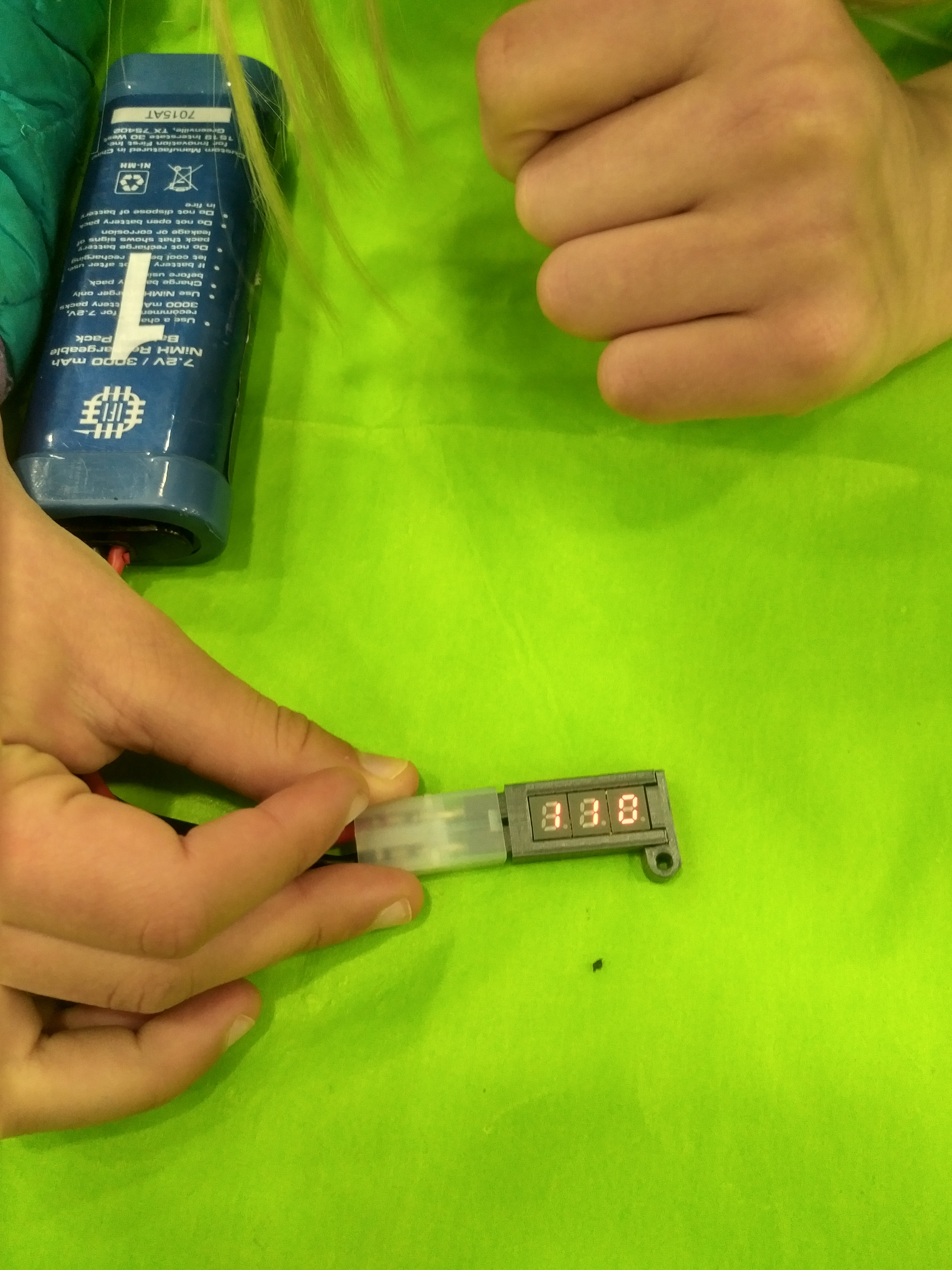

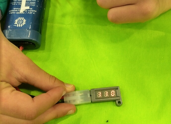

At worlds, my team was giving our alliance partners a battery checker. Plenty of people liked the design, and since I always planned to publish the design, here you go. I’ll add more details later (limited internet access).
Here is the board: OSH Park ~
Photo of the finished device and internals attached.
Measures open circuit voltage, internal resistance and voltage under load (1A, 50ms/1s pulses)

Usage (internal resistance view)
