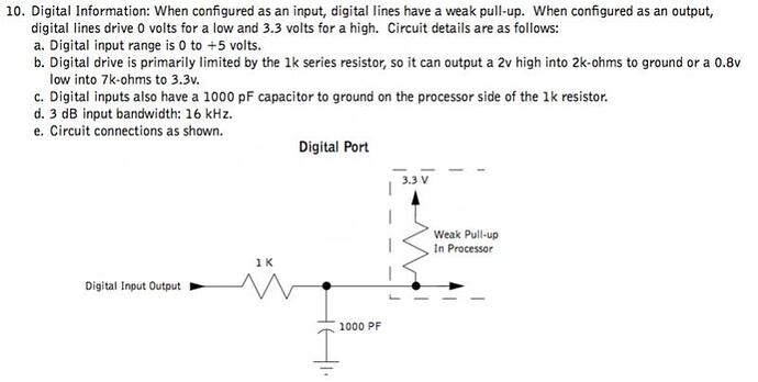

Also, are you saying the Dig IO only has a 5v rail (on the IO not Motor outputs) but no amps?
Cortex digital ports (not motor) have a 1k series resistor to limit current, even without that the STM32 processor could only source/sink about 20mA on a digital IO pin. There’s some detailed info about cortex IO in this thread.

The product description states “Digital, Analog Outputs: Center pin (or middle pin) + 5 Volts, 1 Amp Max combined total from all pins” From this I understand it to be saying that the 5v pins on the connect to the 5v rail which can supply 1A.
Vcc in the sparkfun schematic would be this, and the actual control signal to the BJT is a max of 5mA (1k resistor)

VCC requirment 4-6V, 150 mA
CTRL requirment above 2.6V, 5 mA
That isn’t to say pulling continuous 150 mA from the 5V line is a particularly good idea but at least it should be possible.
Yes, you are correct, I hadn’t looked at the data sheet, not much time for the forum at the moment, too busy. I though OP was going to drive relay directly from the cortex digital IO without intermediate transistor or something. Pulling 150mA from the 5V is fine, we pull about 100mA for each pneumatics solenoid.
