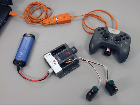

Sounds like you went USB to the joystick, I mean use a programming setup like this (but with the USB A-A cable instead of VEXnet keys if that’s easier).
https://vexforum.com/attachment.php?attachmentid=5038&stc=1&d=1323890069
