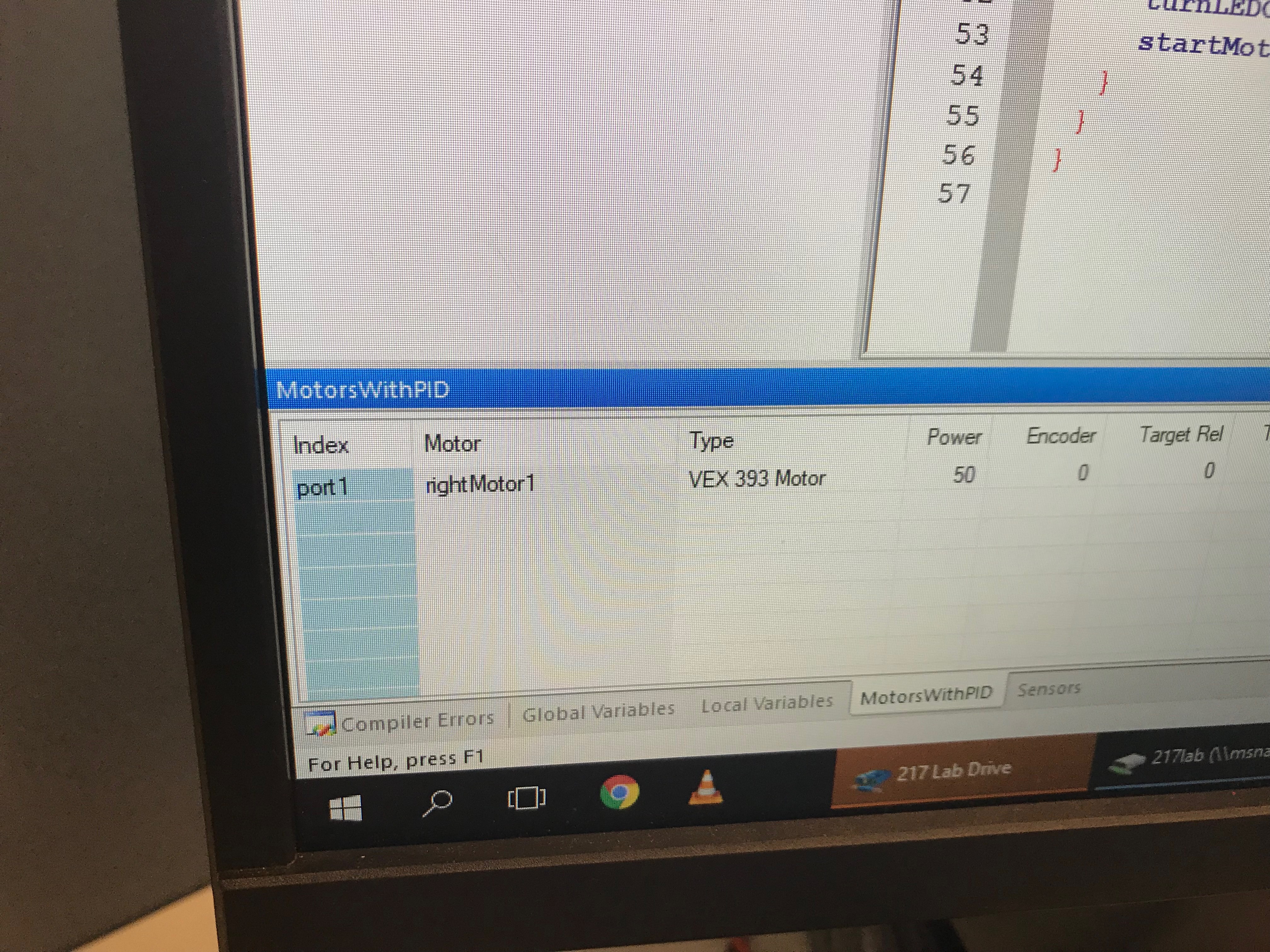

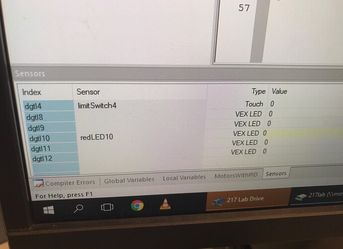

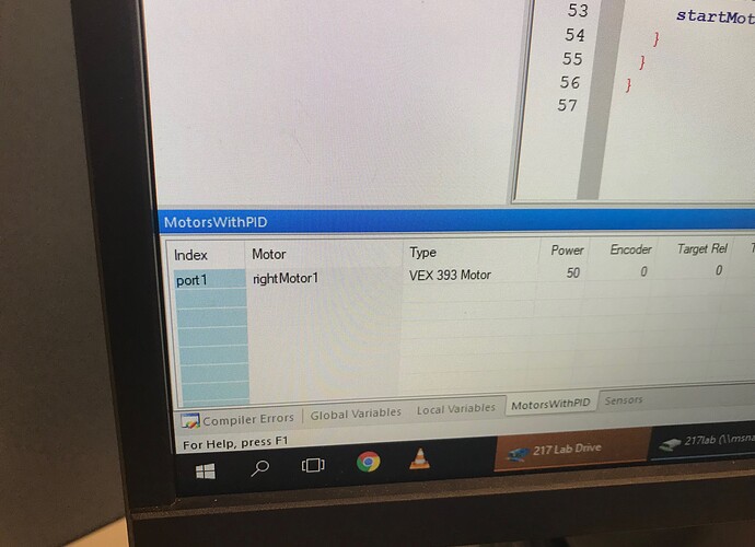

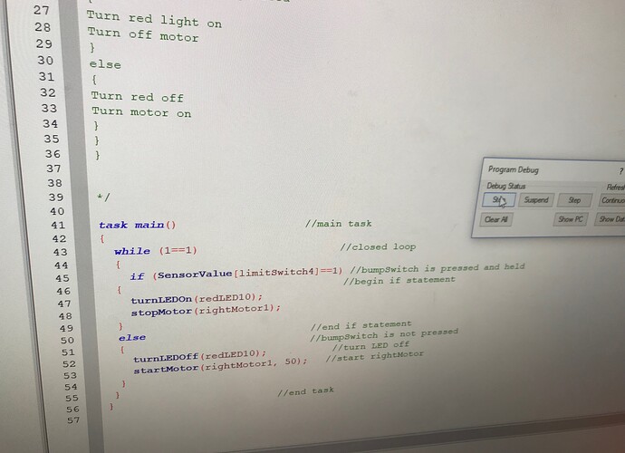

@nenik You are correct - we are running our programs directly through the A-A Cable. Parts of the program run but not all of it. For example, the motor in Port 1 will run but the VEX LED lights won’t turn on. The debugger shows the values are getting set correctly.

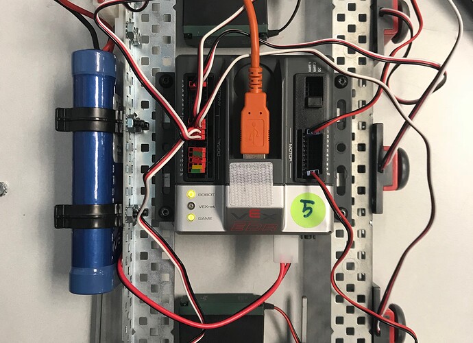

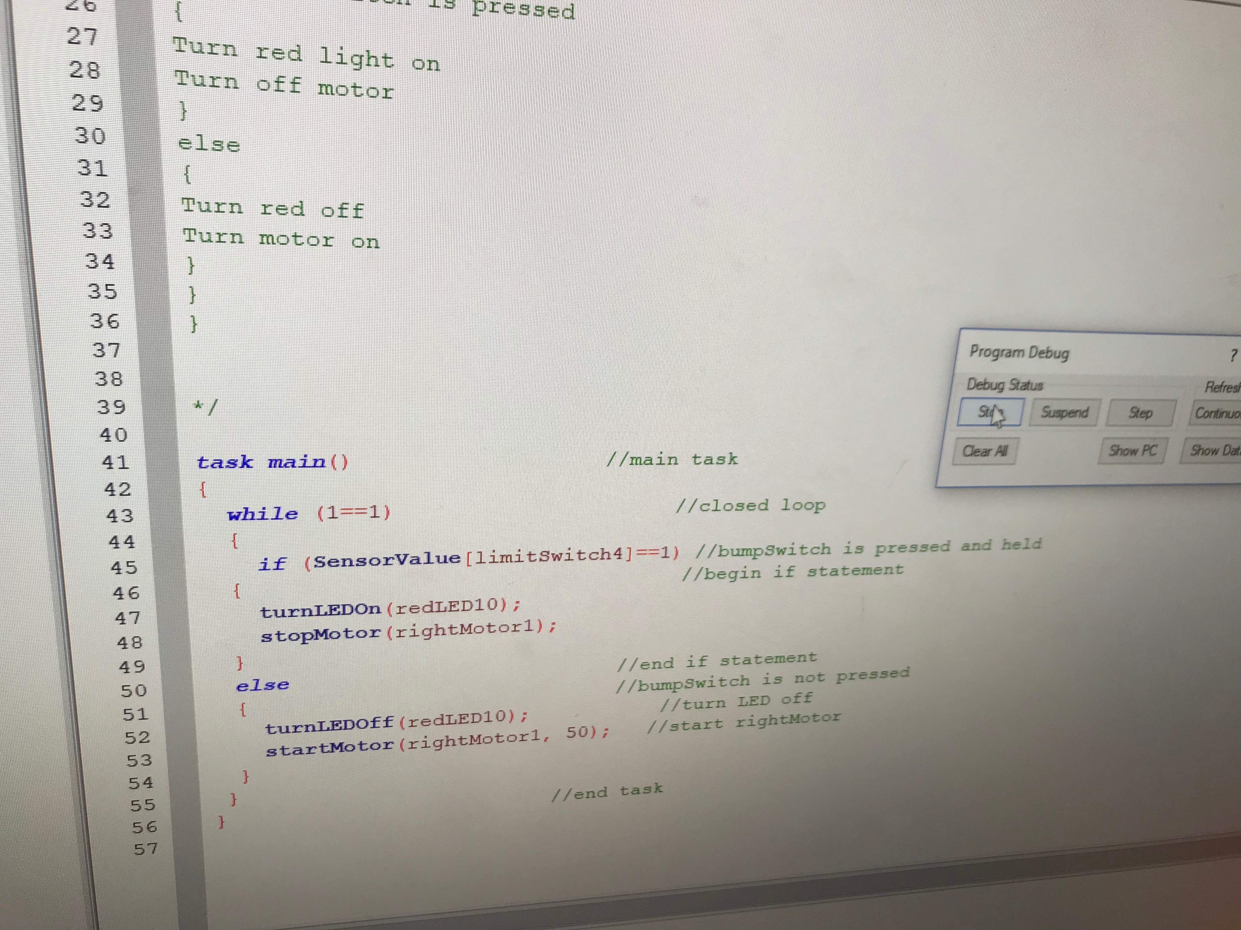

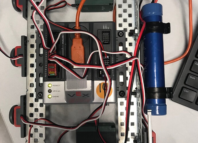

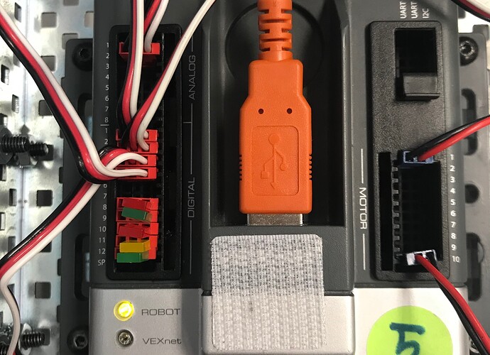

@nenik @Battlesquid @foster Here are some pictures to hopefully help solve the problem. Again, this is a very simple program and the same thing is happening to several cortexes not just one so that leads me to believe that it’s not how things are plugged in.
if you smell a burnt plastic smell it may actually be the internal motor controllers in ports 1 and 10. I have had a hot smelly cortex before and turns out it was the internal motor controllers in ports 1 and 10. your situation may not be as bad as the one I had and maybe you can change ports for the motors.
Your motor in port 9 is definitely plugged in incorrectly. As a rule of thumb, 2-wire cables should never go into 3-wire ports.
In this case, the improper connection is connecting the motor PWM signal through the motor to ground. In other words, the Cortex is trying to run a motor through a connection meant for merely signaling rather than one actually designed for the load of a motor.
@crjohns01 Yep, the easy way to tell is that on the two wire motors it’s red side to the outside of the case.
@Barin --Nice eagle eyes there!!!
@Barin @Foster I wish that were true, but the motor is actually plugged into 10. It’s just bent a little forward. For ports 1 and 10, I’ve always instructed my students to plug in the “notch” on the wires in the same direction as the groove on the port which would make the red wire for port 1 face the outside of the case and the black wire for port 10 face the outside of the case. Is this incorrect?
