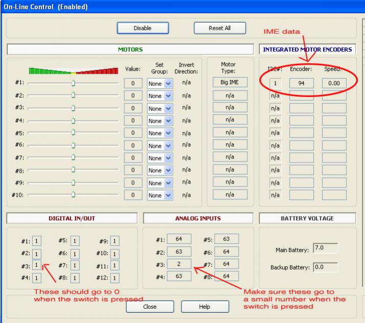

So first you need to make sure the cortex is not damaged by testing all 20 digital and analog ports, you can do this by plugging a bumper switch into each port in turn and checking that it can be detected.

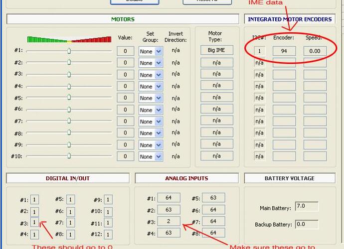

Using EasyC, create a new project and then go into the controller configuration, set all digital ports to inputs (usually just need to change ports 9 through 12). Then download the program, open the online window and check each digital port goes from 1 to 0 when the switch in that port is pushed, don’t try and cut corners, check each one at a time. Do the same for the analog inputs, if all checks out then use a spare motor and perhaps check all the motor ports as well, it’s less likely these are damaged as they have PTC protection.
[ATTACH]7398[/ATTACH]

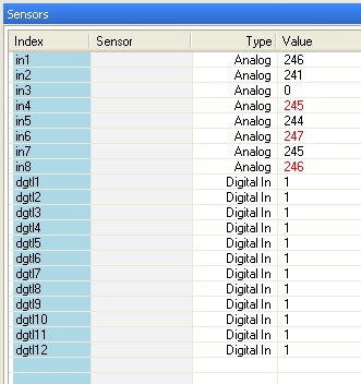

For ROBOTC it’s pretty much the same technique, use some code like this.
#pragma config(Sensor, in1,    ,               sensorAnalog)
#pragma config(Sensor, in2,    ,               sensorAnalog)
#pragma config(Sensor, in3,    ,               sensorAnalog)
#pragma config(Sensor, in4,    ,               sensorAnalog)
#pragma config(Sensor, in5,    ,               sensorAnalog)
#pragma config(Sensor, in6,    ,               sensorAnalog)
#pragma config(Sensor, in7,    ,               sensorAnalog)
#pragma config(Sensor, in8,    ,               sensorAnalog)
#pragma config(Sensor, dgtl1,  ,               sensorDigitalIn)
#pragma config(Sensor, dgtl2,  ,               sensorDigitalIn)
#pragma config(Sensor, dgtl3,  ,               sensorDigitalIn)
#pragma config(Sensor, dgtl4,  ,               sensorDigitalIn)
#pragma config(Sensor, dgtl5,  ,               sensorDigitalIn)
#pragma config(Sensor, dgtl6,  ,               sensorDigitalIn)
#pragma config(Sensor, dgtl7,  ,               sensorDigitalIn)
#pragma config(Sensor, dgtl8,  ,               sensorDigitalIn)
#pragma config(Sensor, dgtl9,  ,               sensorDigitalIn)
#pragma config(Sensor, dgtl10, ,               sensorDigitalIn)
#pragma config(Sensor, dgtl11, ,               sensorDigitalIn)
#pragma config(Sensor, dgtl12, ,               sensorDigitalIn)
task main
    while(1) wait1Msec(10);
Download the code and then use the sensors debug window to check each input goes to (approximately for the analog inputs) 0.

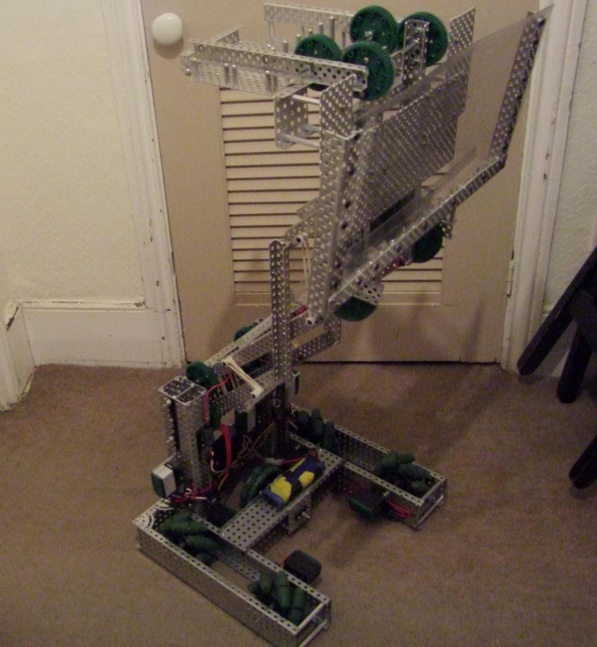

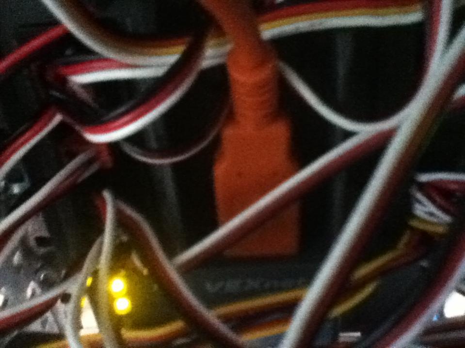

P.S. Here are some pictures of our early wiring and robot in general sorry baout wiring we have had to re-do it many times
Ian
