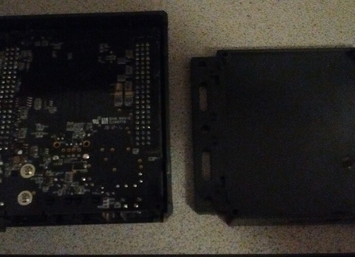

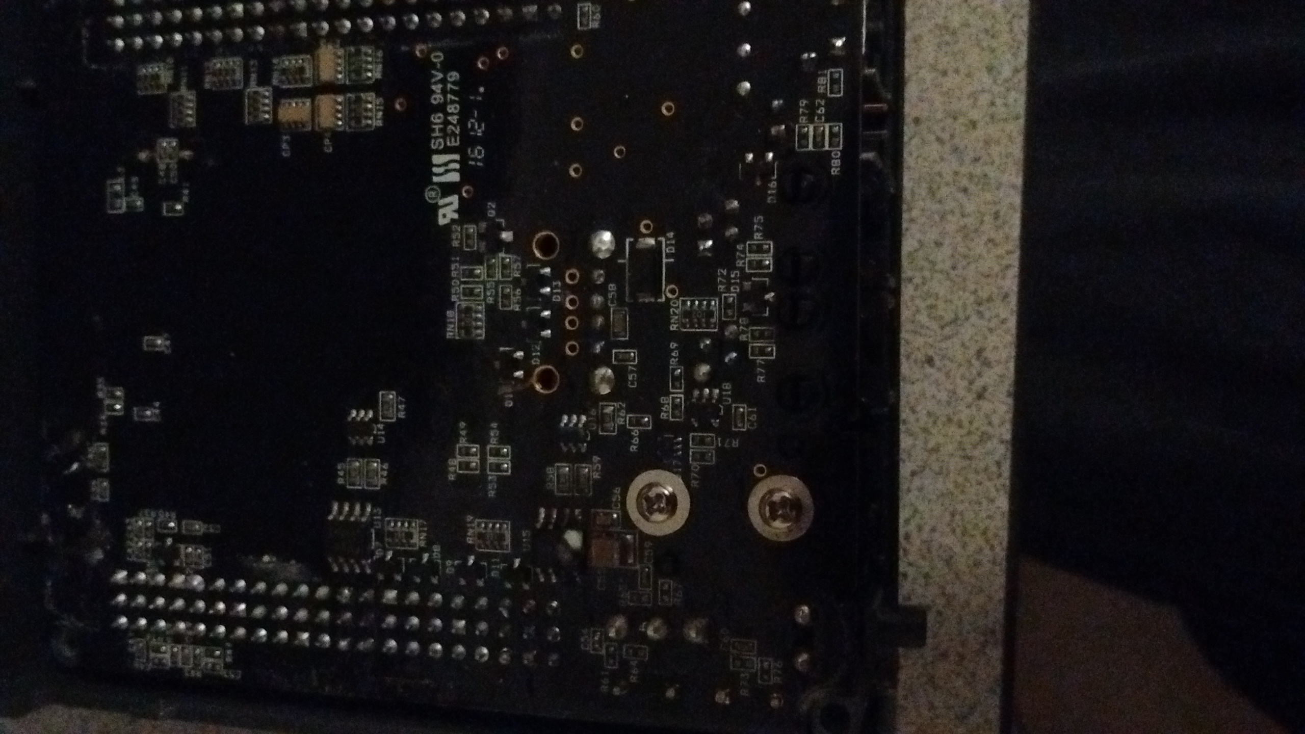

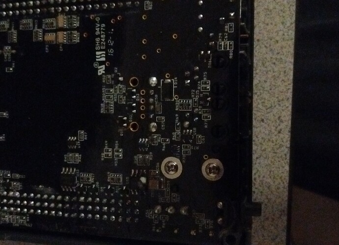

In the past, our cortexes have inexplicably started smoking during use or testing. Our usual procedure is to label the cortex “BAD!” or “FIRE!” in red sharpie, and leave it alone for the rest of eternity, but it happened again to a new (~4 month old) cortex this morning. I was across the room at the time, but @jwwood13 might be able to tell you what he was doing to our poor cortex. Cortexes are rather expensive, so I figured I’d ask to see exactly what went wrong, and how we can avoid it in the future.
I took the casing off, and took some pictures (with my crappy phone camera, sorry). Whatever happened, it was hot enough to scorch and warp the plastic casing. The burn is the white thing, near “U15”. Can you help me at all?
Thanks in advance.

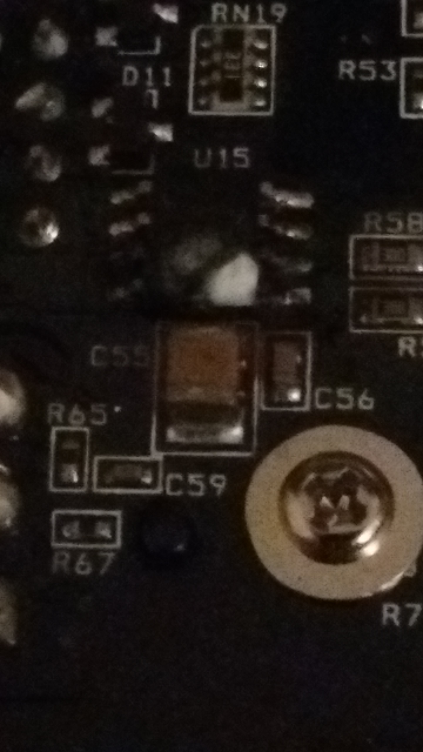

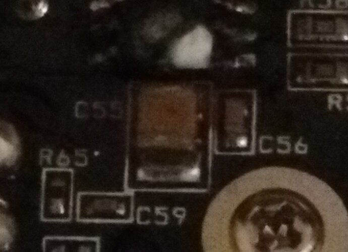

So I see in picture 3 U15 looks toasted, that’s part of the H-Bridge for motor port 10. So you probably shorted the port 10 two wire output somehow, frayed wires on the motor etc.
cortex port 10 killer.

Depending on how damaged the actual PCB is, it may be possible to have someone rework (ie. replace the bad components) for you. VEX service may be able to do this, but will probably charge you. I have put students here in LA in contact with one of my former rework houses and they performed the work reasonably inexpensively. The parts are cheap. So if you can find someone local in Arizona you may be able to get them repaired.

U13 and U15 control motor ports 1 and 10 In most cases a visual inspection will reveal a small white area on the chip or if the short was bad an obvious distortion. These FET chips are SMD and very difficult to replace, but it will fix the issue 9 times out of 10. Digikey did have the OEM part number and you can still look it up for alternatives.
OEM F05 FDS 4935BZ
NOTE: This is a mini soldering repair and unless you have very good soldering equipment and a way to magnify while working, not recommended for most.
Also: I have no idea if this would DQ the bot from competition as it is a user modification.
