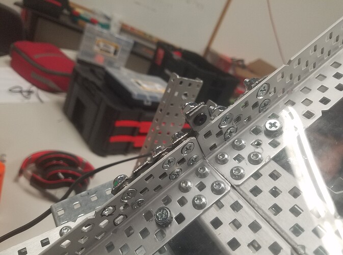

How would counter sinks be made like the one in this photo?
Countersinks are made with a countersink tool, like these: https://www.amazon.com/Preamer-Industrial-Countersink-Working-Deburring/dp/B014O08HF6/
Be sure to get an 82° countersink, of a fairly small diameter, like 3/8" if you want to fit into the angle like the picture shows.
Thanks a ton!

That actually happens to be my robot!
What I had to do was get a bit to drill out a cone shape in the metal, then the countersink screw was perfectly flat.

im going to sound bumb but you have to use a countersink took to make a recess for the screw head then chop the head off?
No, you don’t have to chop the head off. The screw head is flat and will sit within the recess, flush with the metal.
Here is an example of some 8-32 flat head screws. You’ll need to buy them at a hardware store or industrial supply. #8-32 Black Oxide Flat Head Socket Cap Screws
so i just need the countersink tool to make a recess for the screw head? and just need flat headed screws?
That is correct, as you described.
