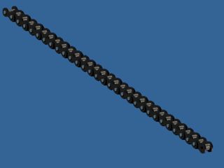

I have worked with chains before in Autodesk, but the same basic principle will apply. When you make the assemblies of 2, 10, 20, 72 links, they are going to be held in that one position that you specified in the original assembly if you place that assembly into the other assembly which contains the rest of your robot.
there are two ways of solving this, one way is to find the distance between the two drive sprockets, if they are arranged linearly, and open up a new assembly. put in two more of the drive sprockets, and constraint them to be the correct distance apart. you can then go and put in your tread pieces, constrainting each one individually. this takes a lot of time, so i would recommend using another method.
start a new assembly, and put into it a bunch of chain/tread links, as well as your drive sprocket. constraint the links together, but leave them with rotational capabilities. form a 180 degree loop with that section of the chain/tread around the drive sprocket. once the chain/tread sections are all in place, delete the sprocket, and save the file. this will enable you to place this 180 degree section of chain/tread into your main assembly.
in order to make a straight section of chain/tread, create a new assembly, and insert a bunch of chain links. constrain them all together, and drag them into a straight line, by grounding on of the end links. this takes a lot of computing power, so you can do that or open up the chain/tread link file, and add a very small rectangular extrusion on one of the flat faces. by using the angle constraint on this new extrusion, you can force the links to form a straight line (or any other angle for that matter).
ive attached pictures of this concept done with chain links in Inventor for my teams 2008 FRC robot
