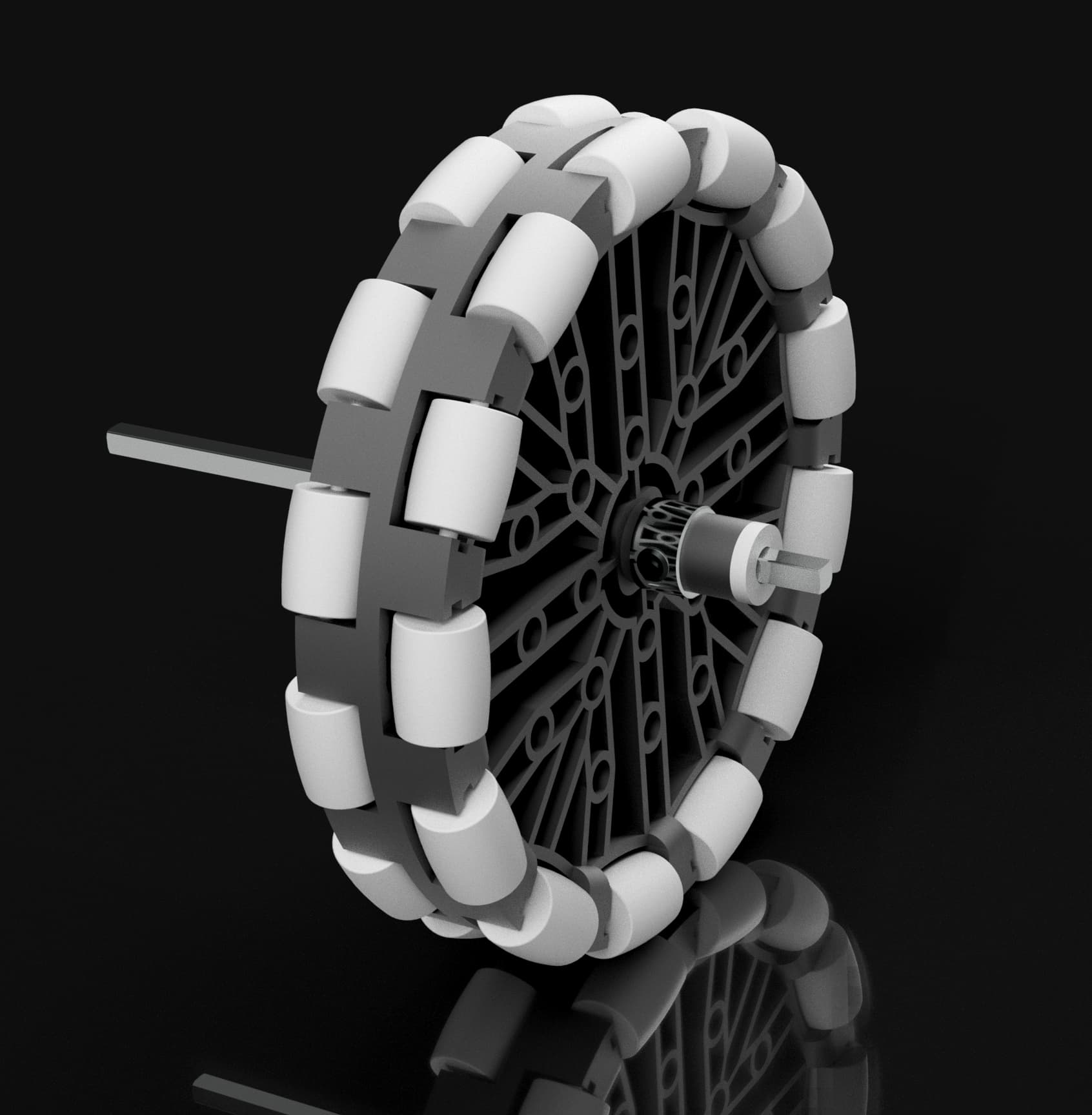

This drive uses 4 4" omni wheels running at 200 rpm. The reason 4" wheels are chosen here is because 3.25" and especially 2.75" wheels are very slow at 200 rpm, and only 4" wheels gives a reasonably decent speed at 200 rpm with no gear ratios.
Omni wheels are chosen for their turning ability. If a robot which has 4 traction wheels and attempts to turn, the traction wheels are forced to scrub sideways on the tiles, which is unpleasant to drive and causes inconsistency when trying to turn precisely. Using all omni wheels allows the robot to turn smoothly with no wheel scrubbing, since the rollers allow for the wheels to move sideways freely. The downside of using all omni wheels is that you can be pushed from the side quite easily. Despite this, many top teams still chose to use all omni wheels because they enjoy the smooth driving they provide and a driver skilled enough can make use of the sideways drifting. The alternative is to have a single set of traction wheels, which still allows for turning without scrubbing, but eliminates drifting and resists sideways pushing. You could experiment with using traction wheels on the front or back of this drive, and you’d find that the robot’s center of rotation will shift to be between the traction wheels. This isn’t necessarily a bad thing, but what a lot of teams do as well is add a third set of traction wheels to the center of a drive to keep the center of rotation centered. This type of drive is not that suited to this sort of layout though, and it would take some level of modification to add that.

This drive has only 4 joints, one for each wheel. These joints are shaft joints, which is necessary so that the motor can drive the shaft and transfer power to the wheel and sprocket.
The spacing on these joints is pretty forgiving as far as tolerances go, but the important things to consider are that the chain and the wheel need to not scrape against each other or the sides of the pontoons, and that the spacing needs to not be too tight. If spacers are crammed into a joint where they don’t easily fit, they will push up against the sides of the joint and create a lot of friction. A good rule of thumb with joint spacing is that you should leave a gap big enough to stick your fingernail in. You should also avoid any metal-on-metal rubbing, which means that shaft collars shouldn’t be touching any c channels directly. Separate shaft collars from metal with at least a washer.
Another important part of this joint is that both the sprocket and wheel need to be locked to the rotation of the shaft, using square inserts. This way the motor is able to transfer that rotational motion through the shaft into the wheel and sprocket. Try to avoid using old omni wheels or sprockets that have plastic square inserts because those tend to wear out and let the sprocket or wheel wiggle against the shaft. This sort of backlash is referred to as slop, and on a drive you really want to reduce the slop to the amount inherent in the motors.
