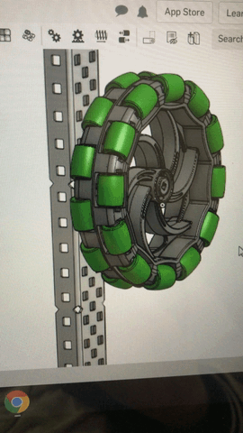

I’m trying to add an omni wheel to the c channel using a revolute mate and it’s not exactly working out… How would you do it???
https://giphy.com/gifs/Xzjv6OkOPCL526aWFE/html5
first, i fixed the c channel so it wouldnt move when the wheel turned, but only do this after the entire robot is made.
Then, i grouped the entire when as a single group cause i uploaded it from a library and i wasnt sure if it would all move together.
so first, select the middle of the hole on the wheel.
Then, select the middle of the square hole on the c channel, any hole you want
Then, make sure they are in the correct order as shown, if they are not, you can rearrange them
Then, off set the wheel as much as you would like.
finnaly, if you right click the revolt mate on the side, click the animate… to see it move.
sorry for the late reply :upside_down_face:
edit: sorry the photos are so bad, i took pics of my computer with my phone just to upload them to my computer but i didnt feel like taking new screen shots

:pray::pray: thank you so much. I was able to get my omni wheel to spin! I know I’m asking a lot of questions but one last one; if I’m trying to make a chain drive, how would I make the chain move around the gear? Since I don’t understand how I would be able to get the chain into the position I want around the gear, nevertheless make it move…

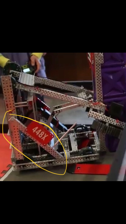

Welp that’s too bad but I’ll probably have to do that. How to diagonally connect something…?? I can’t seem to get it. For example I’d like it to look like this, the diagonal part
Do you need the chain to be diagonal or a piece of metal diagonal? If chain, you have to manually turn all of the pieces the same degree, make the line, and then manually do the curves. If it is for a c channel, then you have to turn in.
To do the c channel easily so the holes line up without trial and error, you could make a rotation mate so the diagonal c channel can turn around the c channel parallel to the ground. Then you can just turn it until the other side is where it should be
