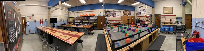

Our robotics workshop is very compact - so we have lots of storage under field for running events, robot storage etc…
/Users/lacsap/Pictures/Photos Library.photoslibrary/resources/derivatives/1/13F966C2-9E48-4D88-9544-4DA77AA4E029_1_105_c.jpeg
When it came to working with the raised field, we never had any issues with students falling off of it. In fact, we even had some members working on the robot that preferred to work in the field. The only thing is that sometimes during practice we would have some game elements fall out, but they never broke since they are often made with the intent of being dropped from small heights anyways.
