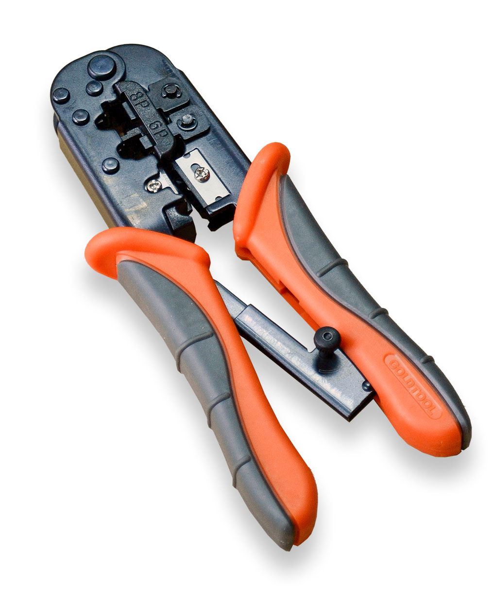

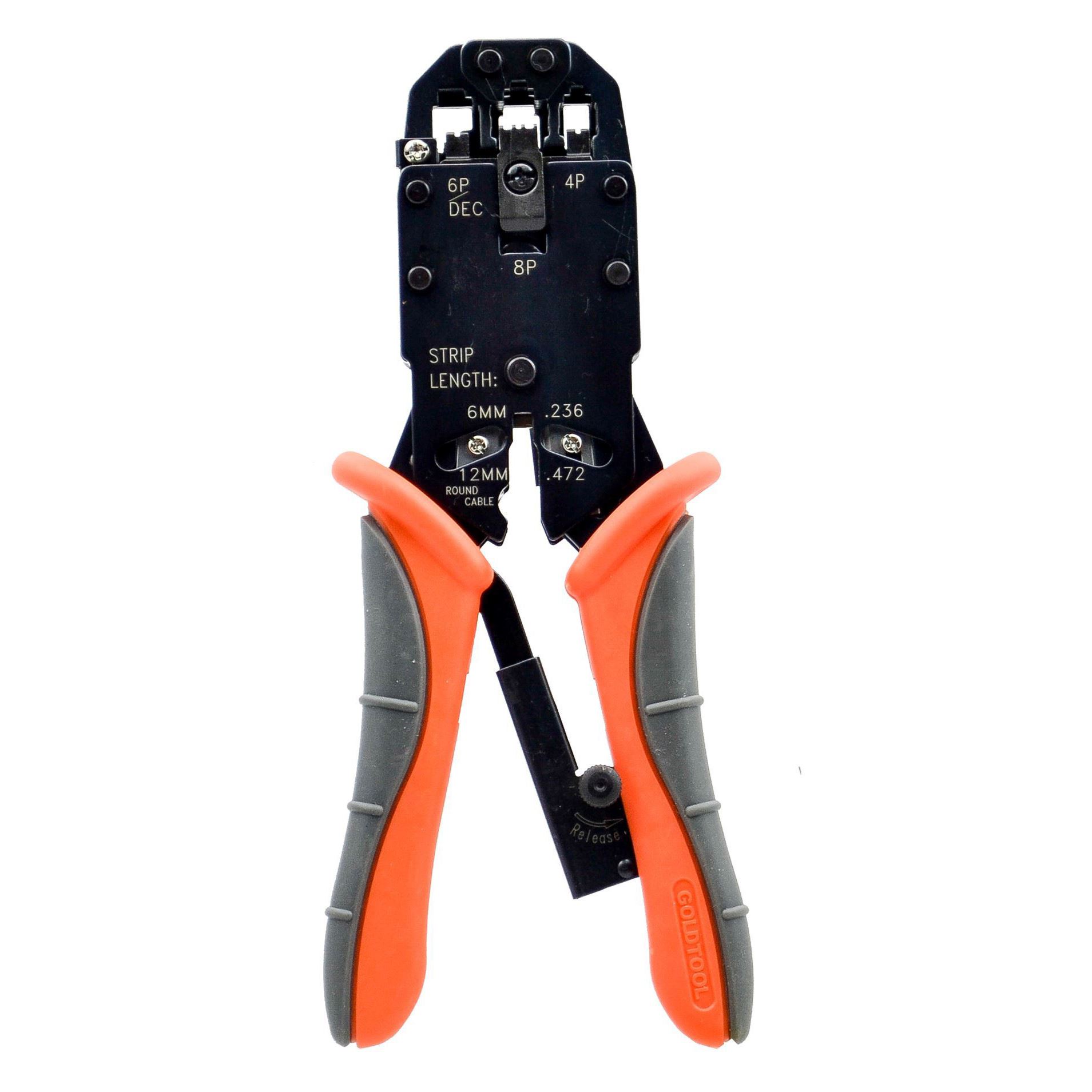

Nice. I have these from Show Me Cable in my personal stash, but unlikely that I’m going to dump it into the local tool parts for the team. Ratchet Modular Crimping Tool | RJ22 , RJ11, RJ12, RJ45 & DEC | ShowMeCables.com
The VEX ones are hand pressure crimps which makes it easy, but there are teams that have the ratchet style (won’t release until the crimp is done). I was looking for experience with other crimpers. Showme has ratchet versions for a few dollars more than the hand pressure ones.
The ratchet crimper is probably a good idea for more consistency. Of course, we have a couple cable testers: Cable Tester Kit with VEX V5 RJ9 Adapter & Zipper Pouch - Robosource.net both to prove custom cables are made right and check existing cables during troubleshooting.

I bought this one a couple of years ago, complete rubbish, never has made a good crimp (assuming it’s not the connectors I bought).
No, RJ11 is 6P2C or 6P4C. V5 smart cables use 4P4C connectors, which RJ9 connectors can be used for.

Good/bad crimp tools in pictures. Anything with a simple pivot will never produce consistent results.
Good
Bad
I’ve got a single pivot crimper with tens of thousand of crimps on it that would like a word with you… not a single bad crimp.
