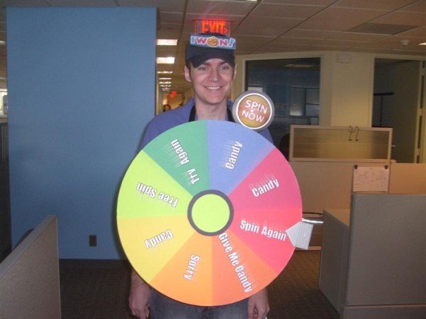

I’m new here, but here’s the first project I’m trying:
It’s a Prize wheel, like you’d see on gameshows or in Vegas. ( or here: http://images.google.com/images?hl=en&q=prize+wheel&gbv=2)
My plan (feel free to poke holes in it):
  1. Player presses bump sensor to start the process off
  2. A Motor spins the Prize Wheel by engaging an attached gear with a gear on the wheel’s axle
  3. Servo lifts motor to disengage it from wheel gear (so the wheel can spin freely)
  4. After X seconds (when the wheel has stopped), the servo lowers the motor to engage the wheel gear again so the process can repeat.
I’d like to be able to read the result of the wheel using the Vex as well, so my plan there is to use the line following kit like so
  1. Line up the three line sensors at different distances from the center of the wheel, on the back. (fixed, not attached to the wheel)
  2. Draw semicircles on the back of the Wheel, lining up with the sensors, so that each “slice” on the front of the wheel has a unique set of semicircles on the back.
  3. Read the semicircles as a binary string. I figure with three sensors I have have up to 8 “slices” on the prize wheel
  4. Notify the player of a win or loss through lights and/or sounds. I don’t think I have anything in my vex kit that can do this. Maybe I’ll spin a wheel with streamers attached or something.
I’ve only built the starter bot with Vex, so I’m not sure if any of this is possibly, really.
sounds cool, its defintely possible but why dont you attach the motor directly (or a 2:1 drive train for toque depending on weight) to the wheel and instead of using line followers i think optical encoders would be easier and take less code
can you post pics when your finished plz?
First, thanks for replying, basicxman. I’m dying to talk about this with someone, but the Mrs. is shockingly uninterested. :slight_smile:
I thought about the optical encoder idea as well, and I think you’re right, it would probably be a lot less code. But for it to work, I’d have to start the wheel in the same position each time (so I know how far it’s traveled), correct? But now that I think about it, that’s not such a big tradeoff for a lot simpler function, so maybe I will give that a try first. I am in a bit of a time-crunch (this is for a halloween costume next week), so this is probably the way to go.
Regarding hooking the motor up to the wheel, do you think that would put a lot of drag on the wheel once I stop powering the motor? I’d like it to have a nice “slow-down” period. Maybe I’ll experiment with that first, as that sounds a lot easier as well.
Mounting the motor that way might also help with another idea I was thinking of: cheating. If I have time, I might try to force the wheel to stop on a “lose” slice for some people, perhaps by holding down a button they can’t see on the back while the wheel spins. Even if it doesn’t look super-smooth, I think it’d be worth it. (In fact, it might be funnier if the wheel is about to stop and then suddenly gains new life to stop on a losing slice). But that opens up a lot of complication, so I’d be surprised if I get around to it in time.
Thanks for the suggestions! I’ll make sure to post how it turns out.

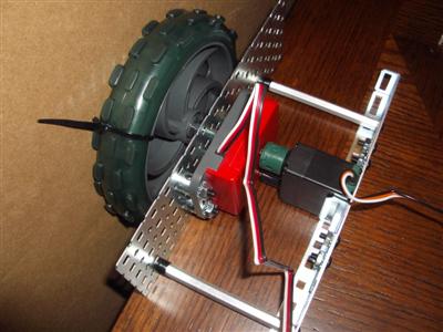

As promised, here are some photos from my prize wheel project I mentioned above. It turned out great. As suggested, I used a motor directly on the axle, and the optical encoder to try to “cheat”.
See it in action here: http://www.youtube.com/watch?v=BKDoC9c9jTo&eurl=http://www.kevincooney.com/archives/000154.php
Read more here: http://www.kevincooney.com/archives/000154.php

thats awesome! i guess this is a bit late but to save money you could have put a tab or nail or something on each section of the wheel and make it hit a limit switch, have the program count the times it hits the limit switch :smiley:
Wow, wish I had thought of that, as the wheel I was trying to imitate has pegs like that. Oh well!
